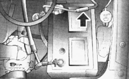

How do you recalibrate the temperature on the heater?

AUTOMATIC TEMPERATURE CONTROL RECALIBRATION The Automatic Temperature Control (ATC) system must be recalibrated if the battery is disconnected or loses power. If it is not, the system will not operate properly. To recalibrate the system: 1. When the battery power is restored, disconnect the electrical connector near the battery. Leave disconnected for at least 15 minutes. See Fig. 2 . 2. Reconnect the connector. Start and run the engine for at least one minute. The ATC system is now calibrated
