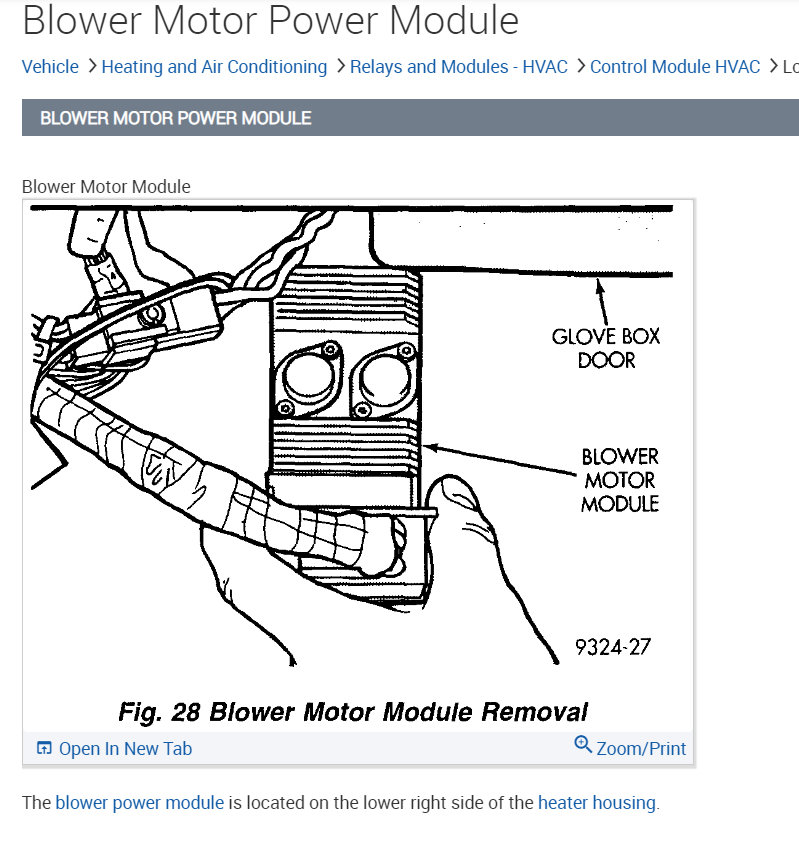

heater blower comes on and blows hot air on it's own?
KCIRTAP
heater blower comes on and blows hot air on it's own with the screen been lit up?
Oct 27, 2010 at 9:19 AM
DAVE H
  • 13,383 POSTS
It sounds like the speed control module is bad, here is the location so you can check it out or get a new one. Check out the diagrams (Below). Please let us know what happens.
