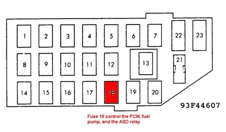

ASD (Automatic Shut Down) relay usually powers the PCM, fuel pump, and ignition. Chrysler installs it a a safeguard from burning out your fuel pump, PCM, and/or other necessary electronics. From your description, it is very likely that the ASD relay has gone bad on you.
It is located under the hood, inside the power distribution center. While you are at it, you may want to check the fuel pump relay and main relay as well. The ASD relay is also controlled by a fuse inside your fuse panel.
https://www.2carpros.com/forum/automotive_pictures/55316_94concordefuse_1.jpg

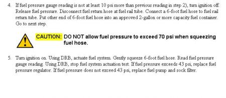

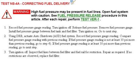

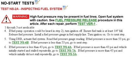

I found this while searching TSB. Try this diagnostic procedure.
https://www.2carpros.com/forum/automotive_pictures/55316_94concordefuel1_1.jpg
https://www.2carpros.com/forum/automotive_pictures/55316_94concordefuel2_1.jpg
https://www.2carpros.com/forum/automotive_pictures/55316_94concordefuel3_1.jpg
Let me know what you find out.

Thanks for that Information. It led me back to the fuel pump. I didn't put the pressure gauge in line but I removed the filter and watched for gas while cranking. Nothing.
I traced the wires to the fuel pump and found that it was receiving power but not pumping.
I took the pump out and applied power and it didn't work so I banged on the side and it started working.
I got another pump from the junk yard and whalaa!
All Good.
So, it looks like the pump was bad all along but intermittent. And the ASD relay was doing what it was suposed to.
