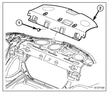

OMG! I'm a 50 year old woman and I've torn this car apart trying to gain access to that dumb 3rd brake light. I've read your advise to others regarding this matter, but it does not seem to fit the configuration I have. I've taken out the complete trunk upper panel only to find a metal plate - no screws for additional access. I removed the trunk light, hopeing to gain access that way - No. I put the seats down and removed the 'button' holding the back 'tray' (don't know the right terms) only to find I would have to remove part of the seat trim package to remove that panel.
Please help. I really don't want to pay someone to 'change a light bulb.'
Thanks, T-

CENTER HIGH MOUNTED STOP LAMP
REMOVAL
https://www.2carpros.com/forum/automotive_pictures/12900_b1_19.jpg
Disconnect and isolate the battery negative cable.
Remove the rear shelf trim panel.

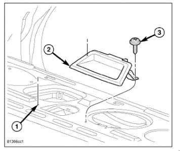

https://www.2carpros.com/forum/automotive_pictures/12900_b2_4.gif
Disconnect the CHMSL electrical connector (1).
https://www.2carpros.com/forum/automotive_pictures/12900_b3_10.jpg
Remove the two mounting fasteners (3) to the CHMSL (2).
