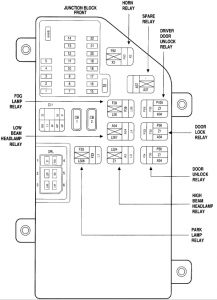

My brake lights wont come on. I have changed respective fuses, bulbs, and the brake light switch. What else could it be?!

Hello –
I just want to make sure on the fuses….you said you changed them…..you still might check them with an ohm meter. Check fuses 7, 17, and 20 on the left end of the dash. Check fuses H and K left side engine compartment.
I don’t have a check for the parking lamp relay but if the above doesn’t show anything, please consider changing the relay.
You said you change the brake light switch….did you adjust it as required?

Here is the location of the park lamp relay also.
https://images.2carpros.com/forum/automotive_pictures/248015_1_98.jpg
