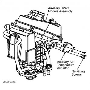

JOHN CHEVY VENTURE
Have a 02 venture with spuratic heat in front, Little when idoling pretty hot when running hard or reving engine. Also no heat in rear no diffrence between AC or heat just strong cold air. Lines to rear are both Hot
I replaced T-Stat , next day flushed system, with rear hoses off also seemed to flush with power no water trickling. Also the front fan speed dial only works on 1,2,4(blower resistor bad) I just can't belive the Intake gasket is causing this condition. Please explain or a fix for this common problem.
Jan 28, 2019 at 6:20 PM (Merged)
2CARPRO JACK
  • 11,533 POSTS
Needing the rpms up to get heat from the front is usually a partially plugged heater core.You will want to be careful if you decide to flush this out yourself using a hose, it isnt that easy to replace it if it pops from too much pressure. The Dexcool (coolant) used in those vehicles would clog heater cores, fairly common issue as long as the cooling system is full with no air pockets.The rear heater could be the blend door (hot/cold door) not working if you have both hoses hot, that usually means the hot coolant is flowing in and out.You should hear a difference in sound in the rear assembly when going from hot to cold, if not the door isnt working. You will have to remove the interior panels to access the assembly to visually see why it isnt working.
https://images.2carpros.com/forum/automotive_pictures/1639_actuator_1.jpg

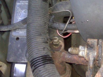

NIZ76
There's a TON of people that have this exact same problem with Chevy Ventures. I was one of them... It is a MAJOR PAIN IN THE REAR to get the air out of the coolant system! Sounds like the problem.. also, b careful cuz ive been told that due to the aluminum heads, they are very prone to blown head gaskets, warping etc. after even only one overheat... There is (actually two) bleeder screws on the coolant system. I use the one on the passenger side of the vehicle because its higher and better to let out extra air... Its located about ten inches to the left of the oil fill cap. It has a hex head (cant remember the size) and its very simple to bleed the air out by unscrewing it a few turns and bleed until coolant streams out. This process took me like two days of repeating until finally my temp gauge and everything is back to normal...
https://images.2carpros.com/forum/automotive_pictures/505181_IMG00122_1.jpg

BIG SPAZMAN
The answer I got from Niz76 was awesome to stop my overheating of my engine and get my heater to blow hot air in my 1997 Chevy venture. it took me 20 minutes to pop the rad cap, release the bleeder nut on the left hand side and start the van and squeeze the hoses on both sides while the van was running. As soon as the antifreeze started running out of the bleeder nut hole, I tightened the bleeder nut and put the rad cap back on tight and took the van for a boot around the block a few times. Problem fixed, no overheating,and awesome hot heat.... THANKYOU
