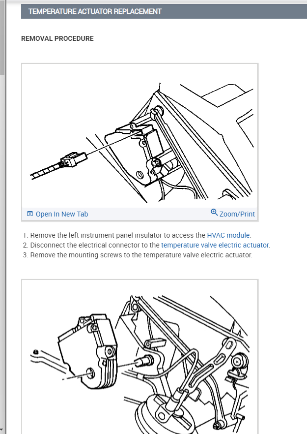

Heater problem
2000 Chevy Venture 6 cyl Front Wheel Drive 185000 miles
front only blows cool air, rear works fine
Sunday, October 25th, 2009 AT 11:08 AM
There are a couple things that can cause this. So, we need to start with the basics.
First and foremost, just check the coolant level.
I understand the rear is working but we need to just make sure so that doesn't bite us.
Then here is a video that will get us into the next areas:
https://youtu.be/SNRb6pSwYuU
If the heater hoses going into the heater core are getting hot, then we have a blend door issue.
So, let's check the temperature of the heater codes and find out if they are the same temperature or pretty close.
If not, then we have a blocked heater core.
https://www.2carpros.com/articles/replace-heater-core

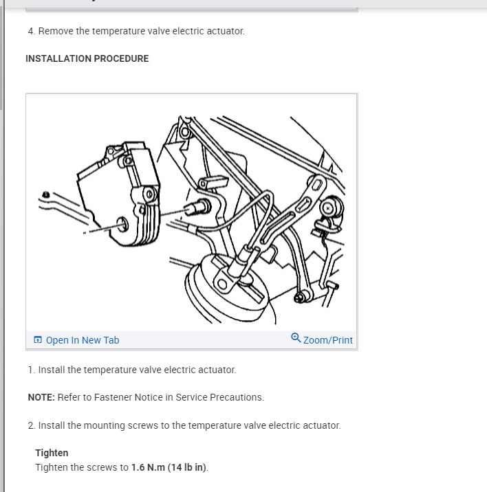

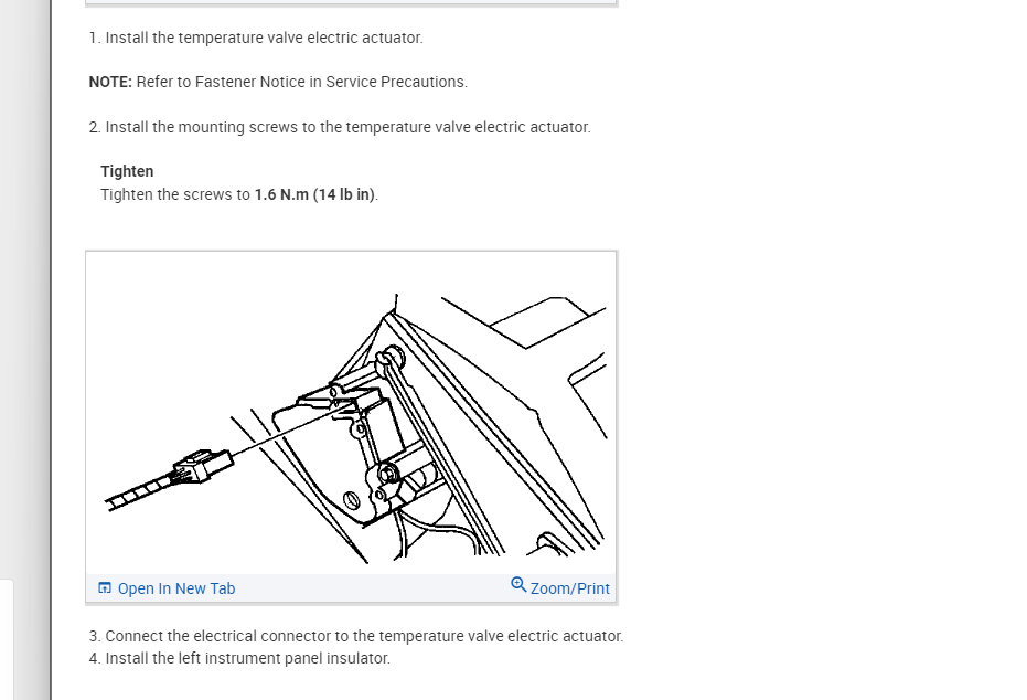

Once we know more about this info, we can take the next steps, but I included the process below for the blend door actuator as that is the likely issue.
Let me know what you find, and we can go from there.
Thanks
