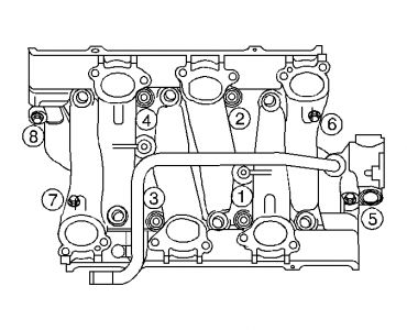

What are the torqu specs for a 2003 Chevy Venture. Do you have a picture of the order inwhich they should be tightened.

Install the lower intake manifold bolts. Tighten: Tighten the lower intake manifold bolts (1, 2, 3, 4) in sequence to 7 N.m (62 lb in) on the first pass. Tighten the lower intake manifold bolts (5, 6, 7, 8) in sequence to 13 N.m (115 lb in) on the first pass. Tighten the lower intake manifold bolts (1, 2, 3, 4) in sequence to 13 N.m (115 lb in) on the final pass. Tighten the lower intake manifold bolts (5, 6, 7, 8) in sequence to 25 N.m (18 lb ft) on the final pass.
https://images.2carpros.com/forum/automotive_pictures/266999_vent_2.jpg
