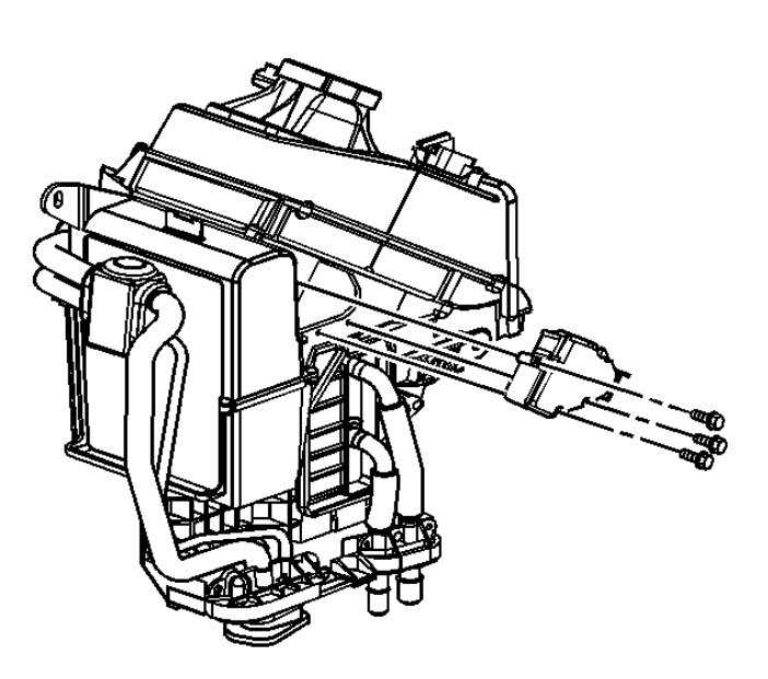

We are on our second Uplander, and both have had the same exact problem.
While idling, the heater will not blow heat. Once you touch the accelerator and rev the engine, heat will flow... upon releasing the accelerator, the air will cool after about 30 seconds, and after about a minute, it will blow continuous cold air until you hit the accelerator again.
The problem seems to be intermittent.
The thermostat has been changed, the coolant has been flushed and all air has been removed from the lines, the water pump has been changed and nothing has fixed the problem. The dealership identified the problem and agrees that it is an issue, and says that all fixes provided by the manufacturer have not worked, so they gave us an entirely different vehicle with LESS mileage, and it worked ok for about a week... it now has the SAME exact problem.
After doing some research online, I have found several other people with the same issue... has anyone found a fix for this?
We do NOT want to go through the hassle of having to get into another vehicle, and would prefer it if the problem would just be fixed. We live in North Dakota and have a baby, so you can understand that not having any heat in our vehicle is a very important issue to us.
If anyone can help or offer any additional information on this, I would greatly appreciate it!

2007 Uplanders were having problems with heaters not working when idling or at low speeds. This was caused by seals seeping or leaking anti-freeze. The heater will become "air locked" The seals were defective. I fixed mine in half an hour without removing the seals.Her is how I did it.....
1. make sure engine is cool, not running for at least 2 hours.
2. Remove coolant cap from reservoir, it will look like there is sufficient coolant in it but go to next step.
3. Remove radiator cap,top of radiator. You will notice you can not see any coolant in top of radiator. Fill with proper mix, before replacing cap, carefully clean any gunk in cap with 409 cleaner or similar cleaner, rinse. Replace cap.
4. Squeeze radiator hose along top of radiator with both hands, squeeze and release several times. remove radiator cap and fill again. Repeat until radiator stays full. Now replace radiator cap and rill reservoir with anti freeze mix to proper level indicator on tank.Replace cap. When all air is out of radiator heater will now work.
If this happens too often you will need to put in some radiator sealer or have gaskets replaced...Chevy knows about this problem and will charge you $$$$ just to remove the air from cooling system.
Good luck.

Mostly this happens on GM cars with air in the system. Do you have heat when you raise the RPM to about 3000-3500?
When engine is cool. Remove radiator cap, loosen the coolant bleeder screws, start engine and let reach operating temperature, turn on the heat, begin raising the RPM to 3000 and hold for about 4 seconds (do by hand on the throttle body if cable actuated so you watch the bleeder screws), be sure to keep the coolant level up in the radiator, keep the bleeder screws open till you get good solid flow of coolant then tighten them shut, once the all the air seems to be out of the system, confirm you have heat at idle, then turn of the engine, when engine has cooled completely, check coolant level at the radiator and top off as needed.

With the engine at full operating temp, locate the 2 heater hoses where they go into the firewall and feel them to see if they are both hot to the touch. If not too hot to hold, then you have to look at the actual engine temp and if that is up, if it is, then your looking at a restricted heater core.
If you find that they are both too hot to hold, then the heat in that vehicle is controlled by a blend door that regulates heated air flow. it is operated by an electric motor/actuator. The problem can be that the actuator is stripped or inoperative or the door itself could be damaged. This is what needs to be determined by examining the actuator and see if it is responding to heat change commands or not.
If they are both not too hot to hold on to, then you either have a restricted heater core or the system is not completely full and getting air pockets for some reason.

No, instrument panel and dash are the same thing. It sounds like you're having a problem with the blend door operation.
