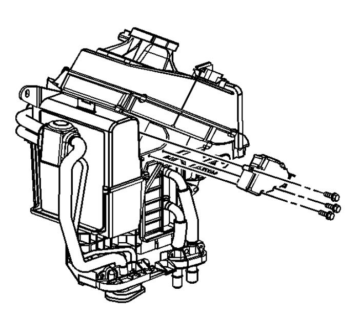

We are on our second Uplander, and both have had the same exact problem.
While idling, the heater will not blow heat. Once you touch the accelerator and rev the engine, heat will flow... upon releasing the accelerator, the air will cool after about 30 seconds, and after about a minute, it will blow continuous cold air until you hit the accelerator again.
The problem seems to be intermittent.
The thermostat has been changed, the coolant has been flushed and all air has been removed from the lines, the water pump has been changed and nothing has fixed the problem. The dealership identified the problem and agrees that it is an issue, and says that all fixes provided by the manufacturer have not worked, so they gave us an entirely different vehicle with LESS mileage, and it worked ok for about a week... it now has the SAME exact problem.
After doing some research online, I have found several other people with the same issue... has anyone found a fix for this?
We do NOT want to go through the hassle of having to get into another vehicle, and would prefer it if the problem would just be fixed. We live in North Dakota and have a baby, so you can understand that not having any heat in our vehicle is a very important issue to us.
If anyone can help or offer any additional information on this, I would greatly appreciate it!

2007 Uplanders were having problems with heaters not working when idling or at low speeds. This was caused by seals seeping or leaking anti-freeze. The heater will become "air locked" The seals were defective. I fixed mine in half an hour without removing the seals.Her is how I did it.....
1. make sure engine is cool, not running for at least 2 hours.
2. Remove coolant cap from reservoir, it will look like there is sufficient coolant in it but go to next step.
3. Remove radiator cap,top of radiator. You will notice you can not see any coolant in top of radiator. Fill with proper mix, before replacing cap, carefully clean any gunk in cap with 409 cleaner or similar cleaner, rinse. Replace cap.
4. Squeeze radiator hose along top of radiator with both hands, squeeze and release several times. remove radiator cap and fill again. Repeat until radiator stays full. Now replace radiator cap and rill reservoir with anti freeze mix to proper level indicator on tank.Replace cap. When all air is out of radiator heater will now work.
If this happens too often you will need to put in some radiator sealer or have gaskets replaced...Chevy knows about this problem and will charge you $$$$ just to remove the air from cooling system.
Good luck.

Mostly this happens on GM cars with air in the system. Do you have heat when you raise the RPM to about 3000-3500?
When engine is cool. Remove radiator cap, loosen the coolant bleeder screws, start engine and let reach operating temperature, turn on the heat, begin raising the RPM to 3000 and hold for about 4 seconds (do by hand on the throttle body if cable actuated so you watch the bleeder screws), be sure to keep the coolant level up in the radiator, keep the bleeder screws open till you get good solid flow of coolant then tighten them shut, once the all the air seems to be out of the system, confirm you have heat at idle, then turn of the engine, when engine has cooled completely, check coolant level at the radiator and top off as needed.

We have a 2005 uplander with hot air heater problems. Start the vehicle for the 2nd time.No hot air, vent selector switch working(set on hot), blower motor switch is working, engine temp good, coolant good, fuse good. When changing functions we could here the switching. Played wtih fan switch and heater switch. Turn van off. Restart play with switches again. All of sudden heat enters the cabin. Happens every 3rd or 4th time the vehicle is used. Taken to dealership. Everything checked out electrically when the heater is operating normally. They suggested replacign the thermostat. Issue did not go away. This can be an expensive endaveour to route casue the issue. I am in contact with the electrical engineer from GM on the program. I post what he finds out regaqrding this issue.
Found the solutuion to the problem. There is a software issue with HVAC module may be exhibiting "Temperature Door Drift".The result of the investigation was a new release of software for service into GM SPO.
Problem statement: GM 2005-2006 Minivan vehicles while operating in full cold mode, the discharge temperature of the supply air stream is not sufficiently cold enough. The rear air stream was operating at design capacity, and blower speed did not affect the overall temperature of the discharged air. As a result of testing it was found that the temperature door within the front HVAC module was exhibiting a “float” condition, where full cold operation was not being achieved.
Drive Complete: When a singular drive (damper actuator) completes, there is a check sequence built into the logic of the control head that looks for any overshoot from the target destination. If there is an overshoot condition, the software will update the current position as the original target position, therefore avoiding and “hunting” by the damper.
These two logic paths (executed within the control head software) operate at different rates. The target update task is executed and checked at a rate of 20ms, while the drive complete task occurs every 100ms.
Root Cause: “Any time the temp knob is turned, there is a chance that an intermediate value can be read and acted on.”

With the engine at full operating temp, locate the 2 heater hoses where they go into the firewall and feel them to see if they are both hot to the touch. If not too hot to hold, then you have to look at the actual engine temp and if that is up, if it is, then your looking at a restricted heater core.
If you find that they are both too hot to hold, then the heat in that vehicle is controlled by a blend door that regulates heated air flow. it is operated by an electric motor/actuator. The problem can be that the actuator is stripped or inoperative or the door itself could be damaged. This is what needs to be determined by examining the actuator and see if it is responding to heat change commands or not.
If they are both not too hot to hold on to, then you either have a restricted heater core or the system is not completely full and getting air pockets for some reason.
