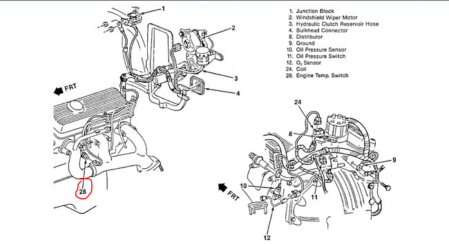

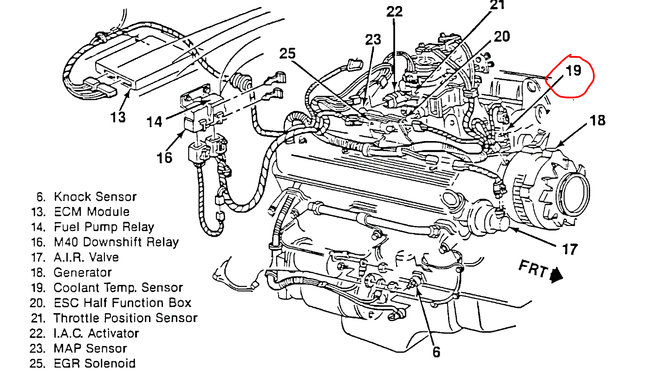

I agree with KaseKenny1 regarding the idle issue. An idle air control can cause issues. However, I noted that you indicated black smoke from the exhaust before it would stall and the condition of the spark plugs.
Black smoke is usually a good indicator that there is a rich fuel mixture. Take a look through this link:
https://www.2carpros.com/articles/engine-black-smoke
Okay, if I am correct and it is a fuel mixture issue (based on fuel pressure there is no change) I have a strong feeling it is related to the engine coolant temperature sensor. There are two on this vehicle. One is for the gauge (see pic 1) and one is for the computer (see pic 2). Now as the engine warms up, the computer uses information from the sensor to determine what the air / fuel mixture should be. If it thinks it's cold, the mixture is made richer. As it warms up, it leans the system. If this sensor is sending the wrong signal, the computer may be making the mixture richer than it should be causing the car to basically flood or run poorly. Additionally, the black smoke will indicate the engine is running rich.

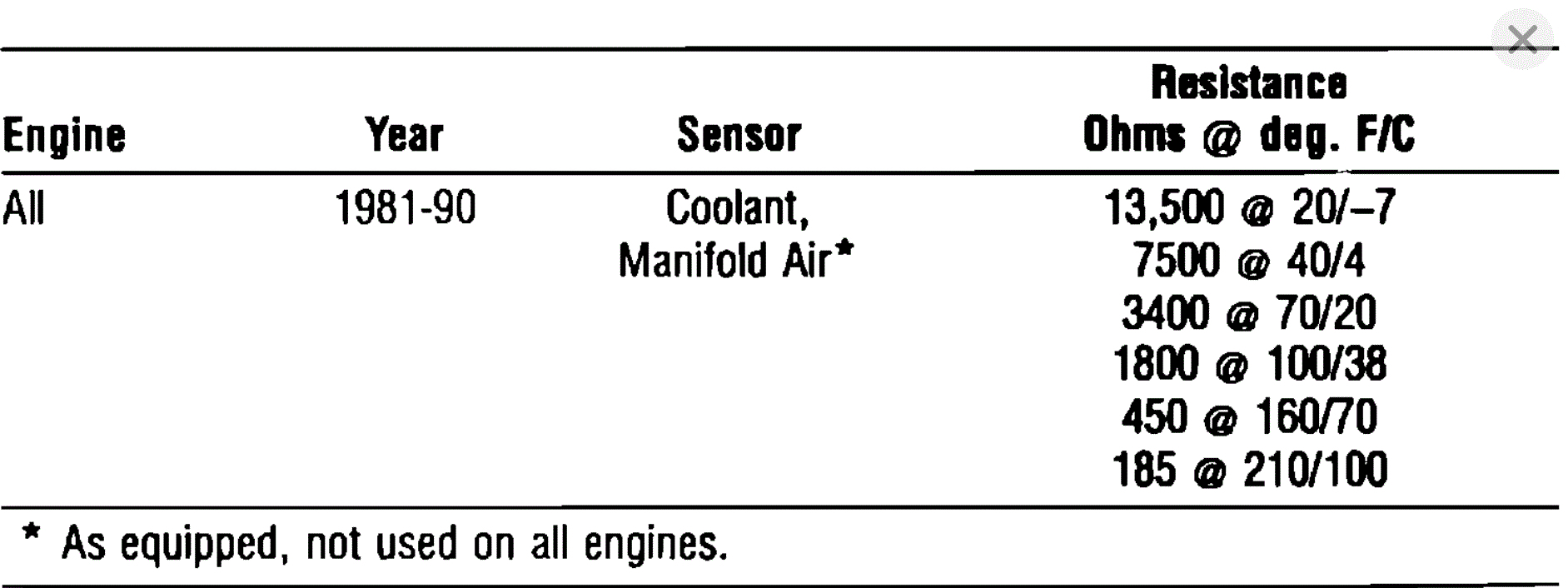

Now, if there are no codes related to this sensor, the next thing is to check the actual sensor. If you look at pic 3, it shows what the resistance should be based on temperature. You will need a multi-meter to do this.
