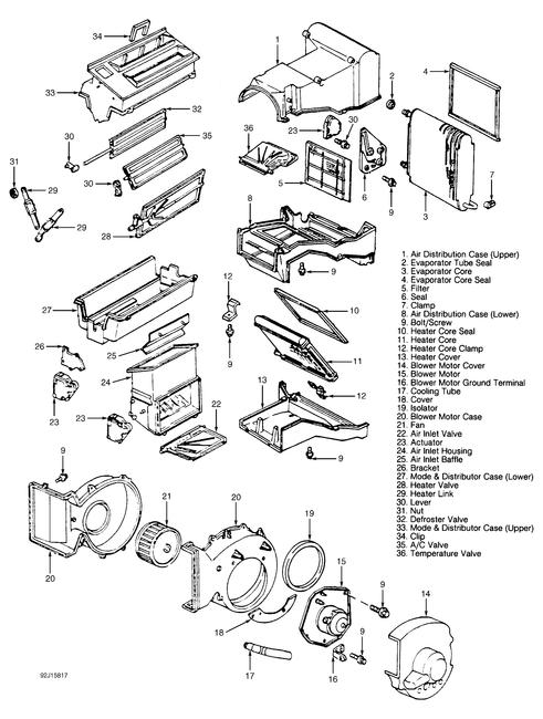

I have no heat both lines going to heater core are hot and the blend door actuator is off and its always on hot
Jan 13, 2021 at 2:43 AM (Merged)
CJ MEDEVAC
  • 11,004 POSTS
i looked at your question. i found this diagram in "prodemand" i researched a chevy pickup k1500 automatic with a manual hvac- if this is wrong, let me know, i look for another diagram. i noticed there are other doors and valves in the diagram, i don't know how they are actuated. This guide can help as well
Check out the diagrams (Below). Let us know what happens and please upload pictures or videos of the problem.

If both heater hoses are hot to the touch then the issue is in the blend door mechanism. Most commonly the problem is the blend door actuator but it can also be an internal issue with the door itself. If you can access the actuator I would remove it and see if you can operate the door wit your fingers and shut the hot air off. If not, the HVAC housing is going to have to be removed and that will mean removing the dash. The temperature actuator is located in the passenger compartment of the vehicle, on the front of the heater case. The instructions state that the dash has to be rolledback to even access the actuator. https://www.2carpros.com/images/external/78936508.gif
