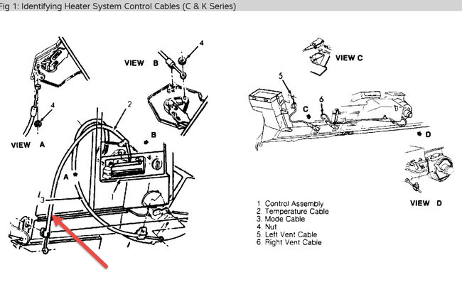

The first thing that comes to mind is the temperature control actuator has gone out. Here is a complete guide on which one it is and how to replace it, here is also a guide on checking the heater out.
and
Please let us know what you find ;)

check for a broken heater cable which controls the heat. it can be broken or the lever is broken/door etc. See picture.

see if both heater hoses are hot they may not be. if they are both hot check for a broken cable for temp also check for a water valve on engine, been a long time for me I forgot if they have them. then have radiator cap pressure checked it may be part of cause not letting engine build up pressure.
