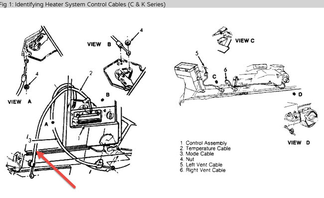

My heat is only blowing cold, does not matter the setting. I replaced the thermostat (works), I flushed the heater core, topped fluid and removed any air in the system. I pulled the actuator which does work off and manually moved the arms for the vents and still it just blows cold. So the heater core in feed and out are both hot, thermostat works, actuator is working and the fluid is topped with no air leaks, but still no heat. What do I do next?
Wednesday, November 22nd, 2017 AT 6:51 PM (Merged)
HMAC300
  • 48,601 POSTS
Check for a broken heater cable which controls the heat. It can be broken or the lever is broken/door etc. See picture.
