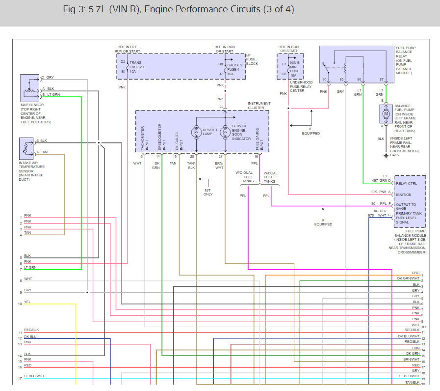

I changed my fuel pump and when I did I redid the wiring inside the tank. This included 4 wires, two grounds and power to the fuel pump and power to the fuel gauge. Now the fuel pump relay keeps burning up on me. The relay gets so hot that it will smoke and the truck will die. When I change out the relay it will start back up. Is it possible that the I mixed the two grounds up or is something else causing this?

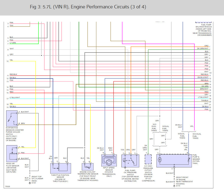

My wiring diagram showed three wires at the fuel pump. The info I looked at was for a 96 K1500 5.7L engine? I also looked at the partsbook for fuel pump connector, it showed a three wire connector. Maybe there is new style and old style?

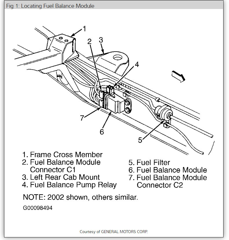

It sounds like you have a bad ground oir fuel pump control module. Here are the fuel pump wiring diagrams and a guide to help you check the wiring and connections.

I got a new fuel pump balance module fix the problem cost $54.00 Thank you so much

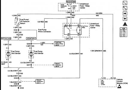

I have a 1997 Chevy 3/4 ton 4x4 automatic truck. The fuel pump relay is getting extremely hot. Checked the frame ground for the fuel pump and it is seems in good order. Replaced the relay with same results. Replaced the fuel pump with the same results. Removed the underhood relay box from weather box and found the gray wire has actually started melting. The wire goes to the fuel pump. Replaced the ground wire on the battery and cleaned all the contact surfaces. No recent repairs, truck has been wrecked and rebuilt. Truck is also high miles. Only OBDII code is an ignition misfire code that has been there for the 3 years I've owned the truck. Another thing that bothers me is the volt meter only reads about 12.5 volts, with a new battery. Haven't had the alternator checked yet but have a feeling it is do to a short in the system. Running out of things to try. Hoping someone might have some advice. Aprreciate any help.

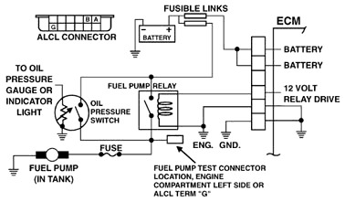

  • 75,992 POSTS
The computer energizes the fuel pump relay by grounding one side of the coil in the relay.
You need to check the fuel pressure, don't let the pump fool you because its coming On-it might be inadequate pressure.
Also look below this how your fuel system is wired
https://www.2carpros.com/forum/automotive_pictures/12900_oil_sending_unit_and_fuel_pump_circuit_11.gif
