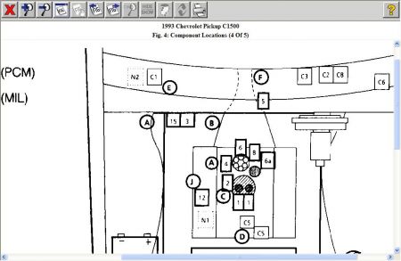

Where is the fuel relay for a 1993 Chevy 4x4 350ci automatic work truck?
Friday, February 8th, 2019 AT 8:01 PM (Merged)
  • 75,992 POSTS
The fuel pump relay is located on right side of firewall near battery jucntion block-see item location no.3 below

Can you tell me where these are located and what exactly they do?
BLUELIGHTNIN6
  • 16,542 POSTS
Your vehicle does not have an intertia (fuel cut-off switch) and the fuel pump relay is similar to a switch that flips on and off. When key is turned on in ignition it flips the "switch" (fuel pump relay) on which allows electrical current to flow to the fuel pump. Your vehicle's fuel pump relay is located on the right side of the firewall, behind the battery junction block cover.
