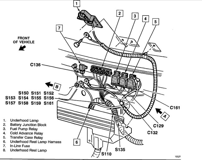

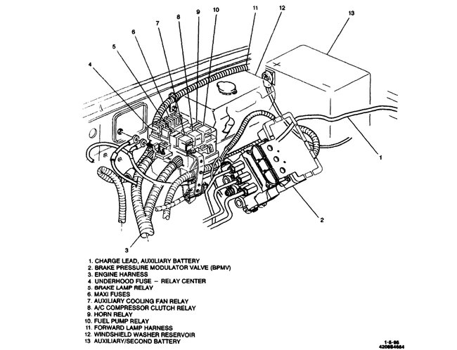

location of fuel pump relay on 1995 1/2 ton chevy pickup?
Feb 9, 2009 at 2:02 PM
  • 75,992 POSTS
The fuel pump relay is Its in the underhood fuse/relay center. Here is a guide to help you test it and diagrams below to show the location.

  • 54,849 POSTS
The fuel pump relay is on the right side of the firewall near the battery junction block cover. Item location no.3
Here is a guide top help you test it

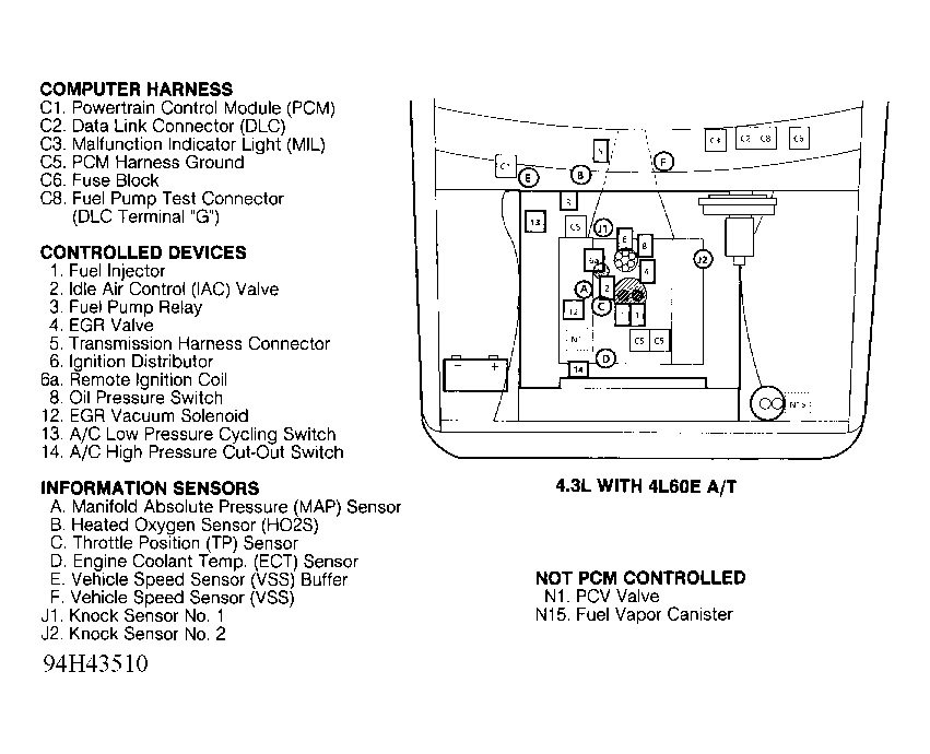

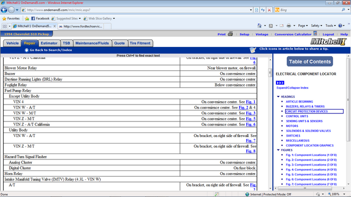

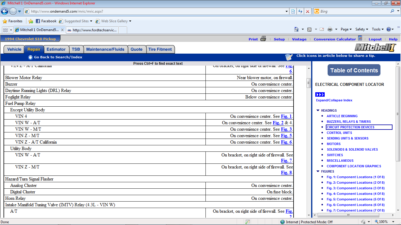

RIVERMIKERAT
  • 6,110 POSTS
VIN code? California model? See image.

RIVERMIKERAT
  • 6,110 POSTS
Yes, the VIN code is part of the VIN#.
Have him spray carburetor cleaner into the air intake and see if that keeps the engine running. If so, he has a fuel delivery issue. No matter which engine (VIN code) it is, the fuel pump relay is located in or near the main relay/fuse/junction box. The code basically tells us which location in the box it is.

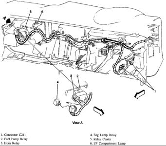

DREWADH
Engine Mechanical problem
1996 Chevy Truck 6 cyl Two Wheel Drive Automatic
were is the fuel pump relay at on a 96 s10
Feb 8, 2019 at 8:01 PM (Merged)
  • 75,992 POSTS
Fuel Pump Relay
https://images.2carpros.com/forum/automotive_pictures/12900_fpr_5.jpg

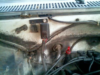

CHASETARD
1987 chevrolet 1/2 ton 2wd 5.7ltr 350ci TBI customdeluxe 10 P.O.S.
https://images.2carpros.com/forum/automotive_pictures/370299_061809_2015_1.jpg
2CP-ARCHIVES
  • 4,540 POSTS
I have a no start and have replaced the fuel relay and still nothing everything I've read said to check the ecn b fues, but I can't find the location. Can you help me with that?
DOCFIXIT
  • 18,828 POSTS
That is the fuel pump relay do not know what Auto Zone gave you. Find orange and red wire jumper this will hot wire pump.

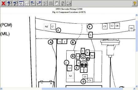

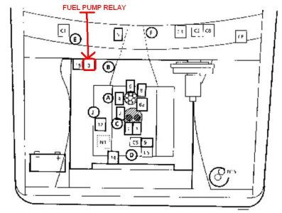

BILLABBOTT
Where is the fuel relay for a 1993 Chevy 4x4 350ci automatic work truck?
  • 75,992 POSTS
The fuel pump relay is located on right side of firewall near battery jucntion block-see item location no.3 below
https://images.2carpros.com/forum/automotive_pictures/12900_fp_relay_3.jpg

ROSUL22
can you tell me where these are located and what exactly they do?
BLUELIGHTNIN6
  • 16,542 POSTS
your vehicle does not have an intertia (fuel cut-off switch) and the fuel pump relay is similar to a switch that flips on and off. when key is turned on in ignition it flips the "switch" (fuel pump relay) on which allows electrical current to flow to the fuel pump. your vehicle's fuel pump relay is located on the right side of the firewall , behind the battery junction block cover.
