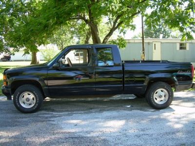

I have a 93 K1500 4X4, an the other day when i got in and started it the brake pedal went to the floor, well i managed to get it home about a 12 mile trip on the back roads.After putting it under the carport I checked the fluid and the front reservoir was almost empty, so i refilled it started the truck pressed the brake and still it went to the floor,so I got under the truck and start looking while my wife was pressing the brake and I saw fluid coming from the steel line on the frame,which by the way is rusted the line that is, my first thoughts was well there goes money to a brake shop to replace the line. Upon further looking at this rusted line I saw where it connects right above the gas tank, so I can replace it myself, question is can it be done without removing the gas tank? Any insight or tips would deeply be appreciated. [img:03e5b5ef84]http://www.2carpros.com/forum/automotive_pictures/268310_Black_Beauty_1.jpg[/img:03e5b5ef84]
