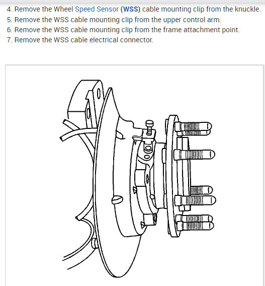

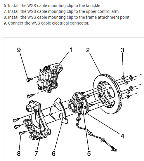

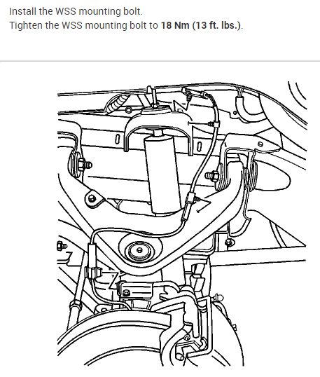

On the way back to switzerland the padel start vibrations, shakes and moves up und down when I use the brake?
May 12, 2008 at 4:22 PM
DANNY L
  • 5,648 POSTS
Hello, I'm Danny.

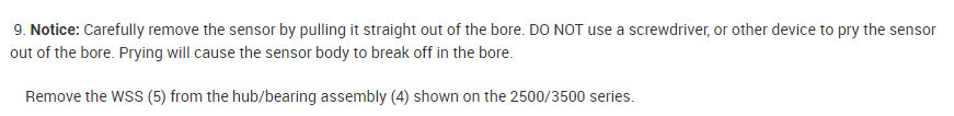

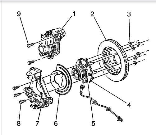

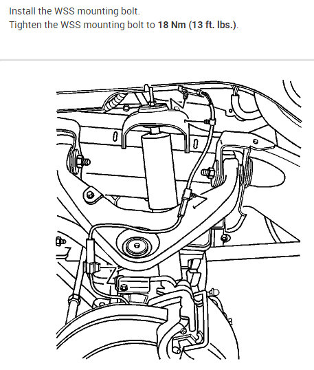

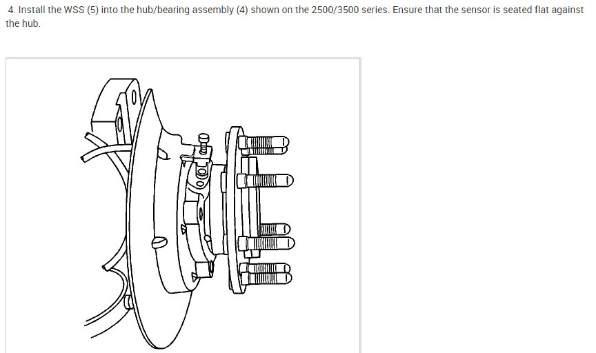

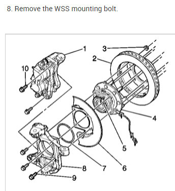

Here is the information you requested. The wheel speed sensor is built into the hub assembly. Here are guides to help you step by step with instructions in the diagrams below to show you how on your truck:
https://www.2carpros.com/articles/how-to-replace-an-abs-wheel-speed-sensor
https://www.2carpros.com/articles/bearing-hub-replacement
I've attached picture steps below on how to change the wheel speed sensor-hub assembly on your truck. Hope this helps and thanks for using 2CarPros.
