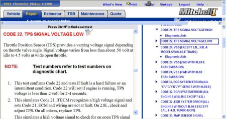

Engine Performance problem
1992 Chevy Truck V8 Four Wheel Drive Automatic
Throttle position sensor
(TPS) - signal voltage is
low during engine idle.
OR
Fuel cutoff relay circuit -
open or shorted to ground.
Code 22
How do I fix this?
Thursday, December 4th, 2008 AT 8:59 PM
  • 75,992 POSTS

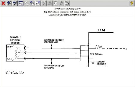

DTC 22 Throttle Position Sensor (Signal Voltage Low)
