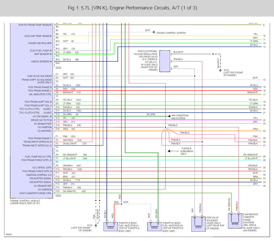

Truck suddenly would not start this morning. Originally had no fire past distributor. Replaced distributor cap and rotor but not working. Eventually turned distributor and now have spark at plugs but no fuel. Eventually found no voltage from ECM going to fuel relay on green/white wire. I applied twelve VDC and activated the relay. Measured twelve VDC on the output gray wire all the way to the fuel pump. Pulled off one of the fuel injector connectors and applied twelve VDC to the injector and it activated but still no fuel. What should the resistance of the fuel pump be? I do not hear it running. Need to know what other sensors if any can cause the ECM to not power this relay and am concerned that there is something else that the ECM is seeing to cause both the spark and fuel problems. Presently I can pour gasoline in the carburetor and the engine wants to start so it is a fuel issue at this time. Any suggestions would be appreciated.

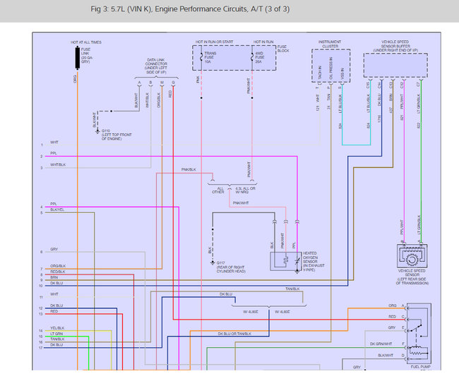

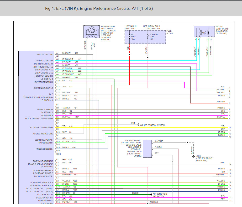

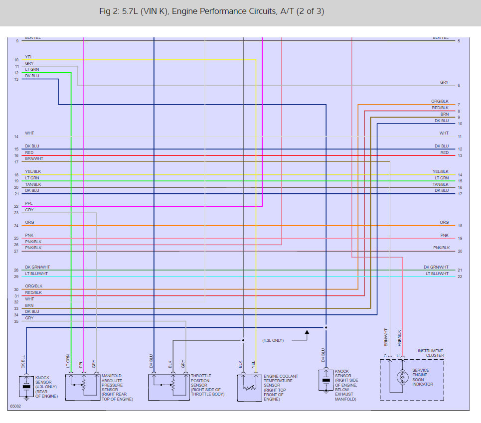

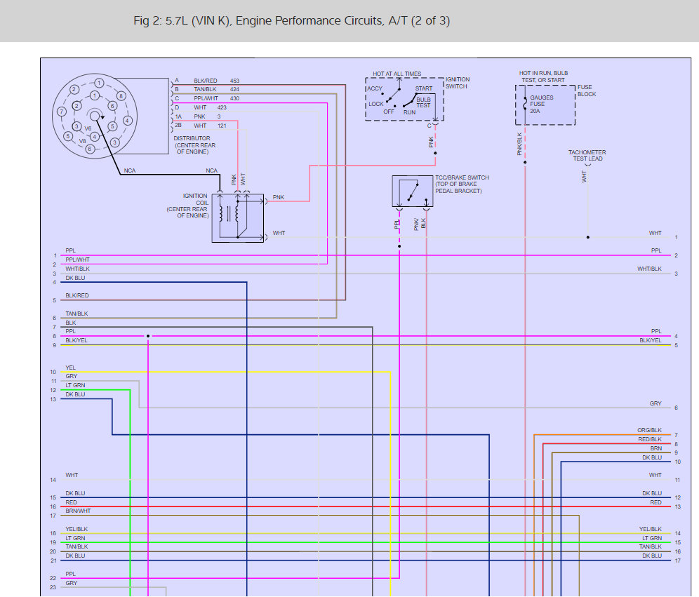

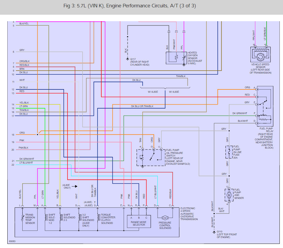

Sounds very similar to the issues I am having with my truck.
Take a look at this post:
https://www.2carpros.com/forum/1992-chevy-truck-chevy-43-no-start-no-fuel-vt191543.html
Here are some wiring diagrams they gave me (below):

I will check the fuel pump today, but even if it would have worked after I forced the fuel pump relay to activate, my thoughts are that the ECM would not have fired the injectors as it does not send voltage to the fuel relay coil winding and something seems to be telling the ECM to stay shut down like an emergency fuel cut-off switch. I cannot find one in the chassis electrical diagram though. Wished I had a detailed schematic diagram of the ECM as it would help in figuring out what is broke.

I measured the fuel pump resistance from the connector that feeds the pump on the gray wire to ground and it is opened. I measured to the ground lug to make sure and also stuck a sewing pin into the wire a few inches from the lug and measured to chassis with zero ohms and did the same on the gray wire to the connector to rule out the connector. I am in the process of removing the bed to replace the pump. I still do not understand why the ECM does not power the fuel relay. I will replace the fuel pump and screen, have replaced the inline filter and will continue from there. Will ground the G terminal afterwards if it still does not function. Will let you know the results. Thank you.

Merlin2021, I grounded the G contact at the test connector and the fuel relay would activate when the ignition switch was turned on. I removed the ground from the G contact and turned on the ignition switch and the fuel relay came on but only for about two seconds. Turning the ignition switch on again did nothing. I then replaced the fuel pump, grounded the G terminal for a few seconds, heard the fuel pump work, removed the ground and heard the fuel pump turn off and then started the engine.
