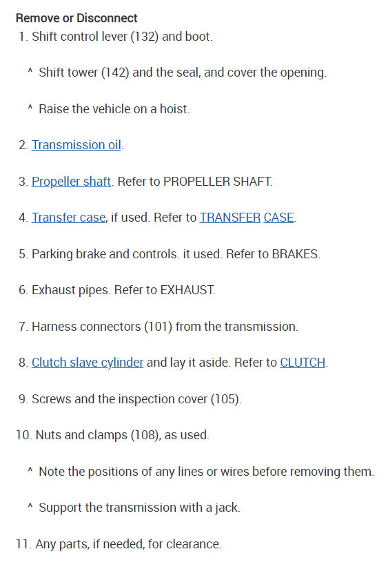

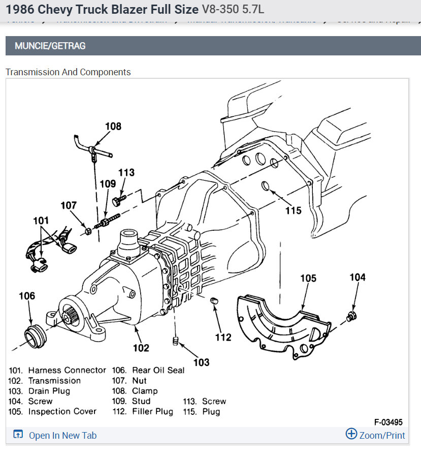

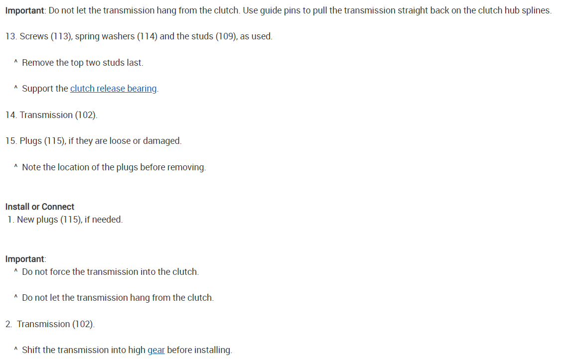

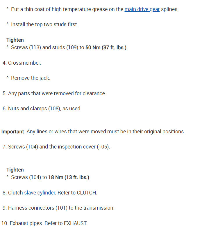

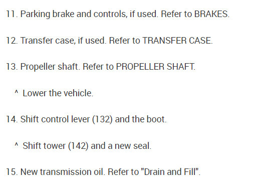

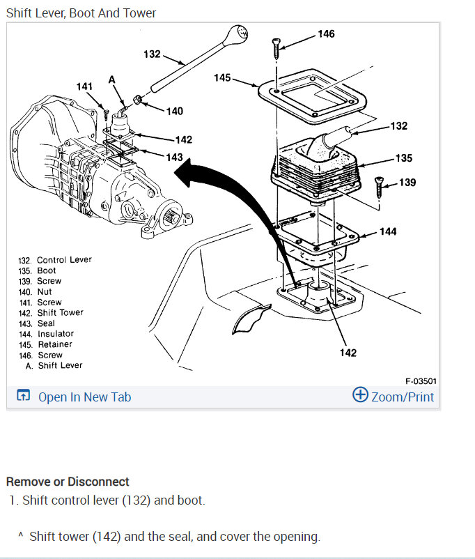

I have a 86 s10 blazer. The clutch pedal does nothing when the vehicle is running. I can start the vehicle by depressing the clutch and putting it in gear but than cannot shift gears once running?? Any ideas would be greatly appreciated...
thanx
Feb 6, 2006 at 12:33 PM
2CARPRO BOB
  • 45 POSTS

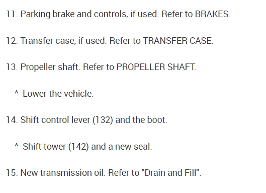

This happens when the clutch falls apart or the pilot bearing seizes up and will not allow the input shaft to stop spinning. Here is how to remove the transmission and clutch in the images below. These guides can help as well.
https://www.2carpros.com/articles/how-to-replace-a-clutch
and
https://www.2carpros.com/articles/clutch-doesnt-work-sometimes-or-not-at-all
Check out the images (below). Let us know how it goes

Suggested Repair
Remove the transmission and inspect the clutch and pilot bearing. A clutch that has come apart or a seized pilot bearing can keep the input shaft spinning, so the pedal does nothing and the transmission cannot be shifted while the engine is running. Repair or replace the failed clutch components as indicated.
