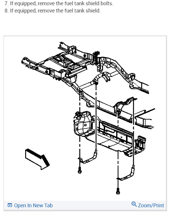

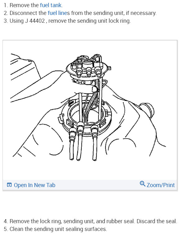

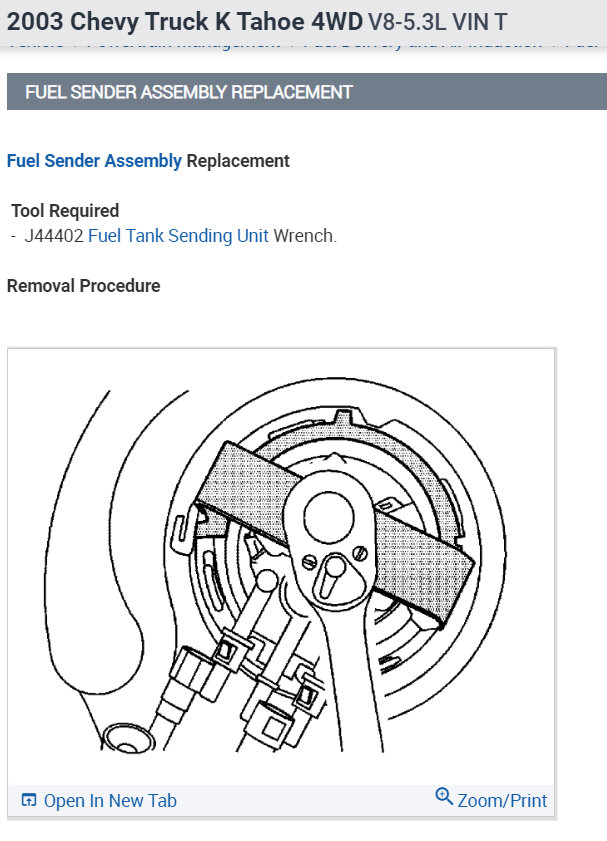

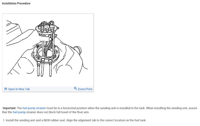

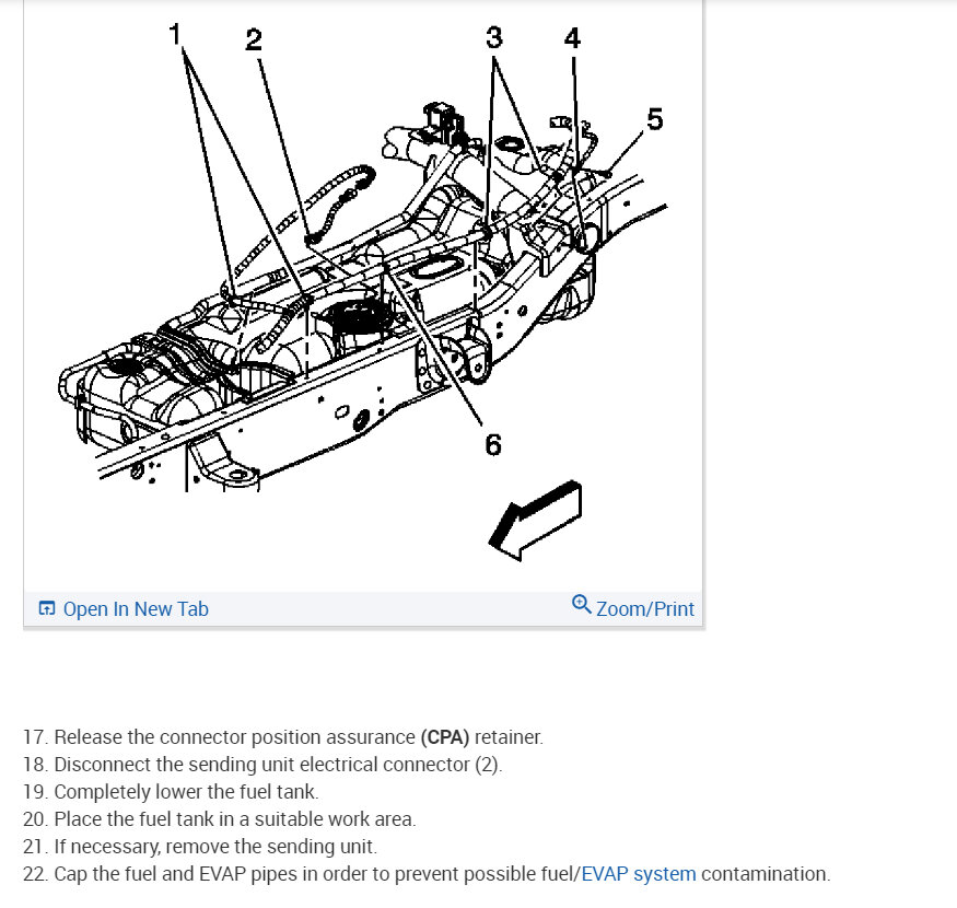

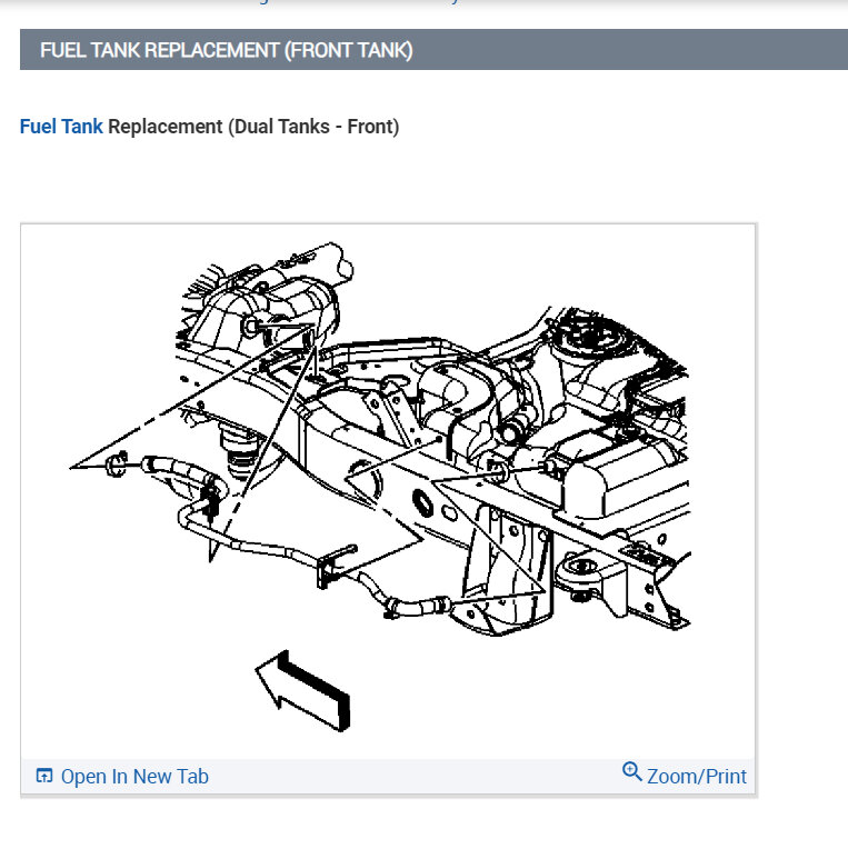

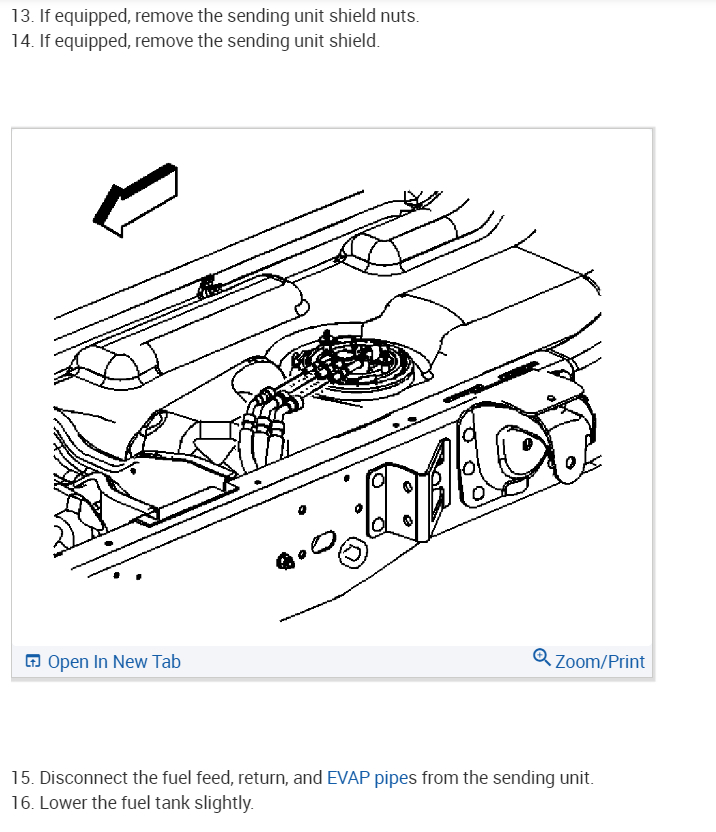

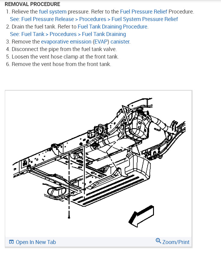

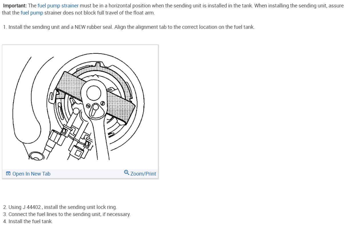

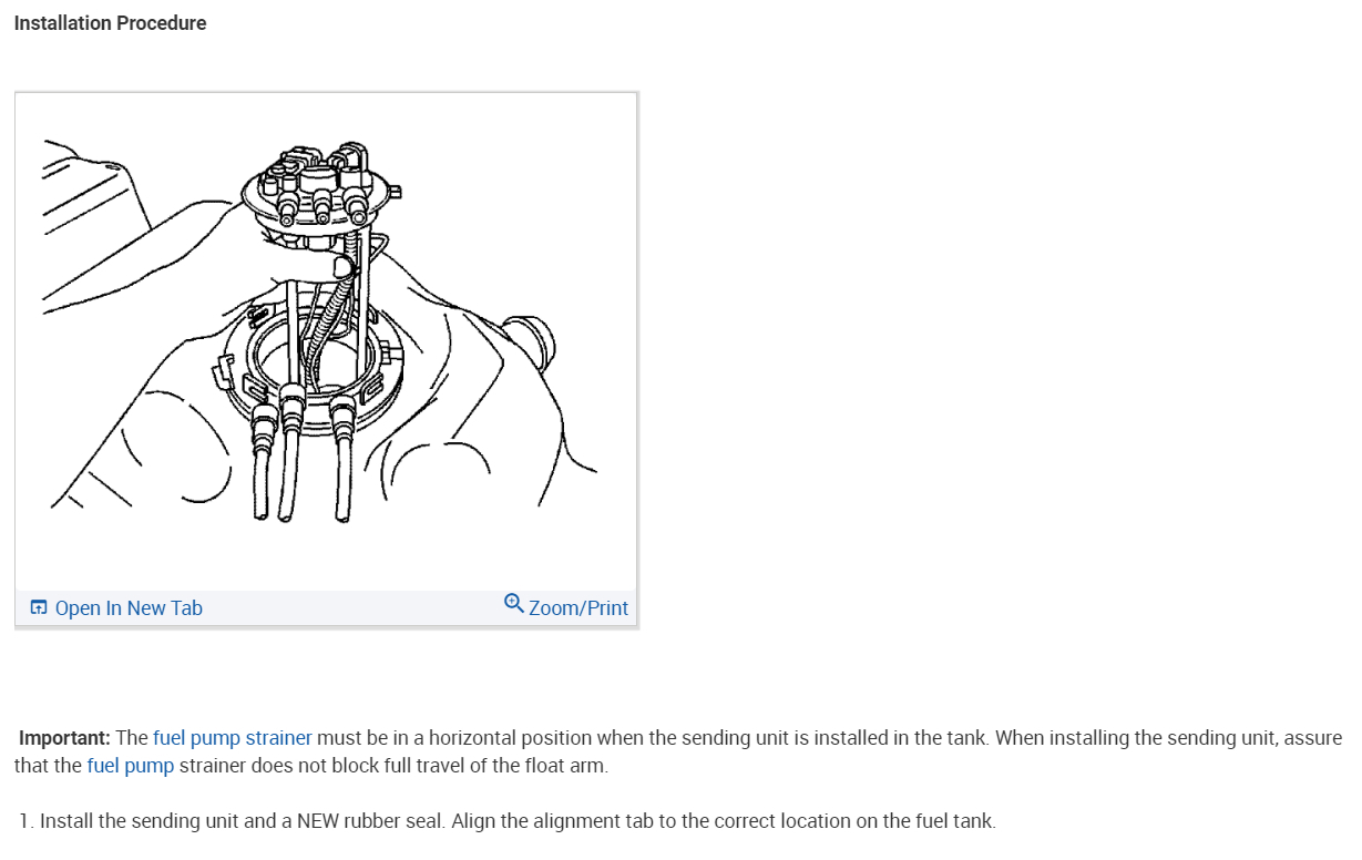

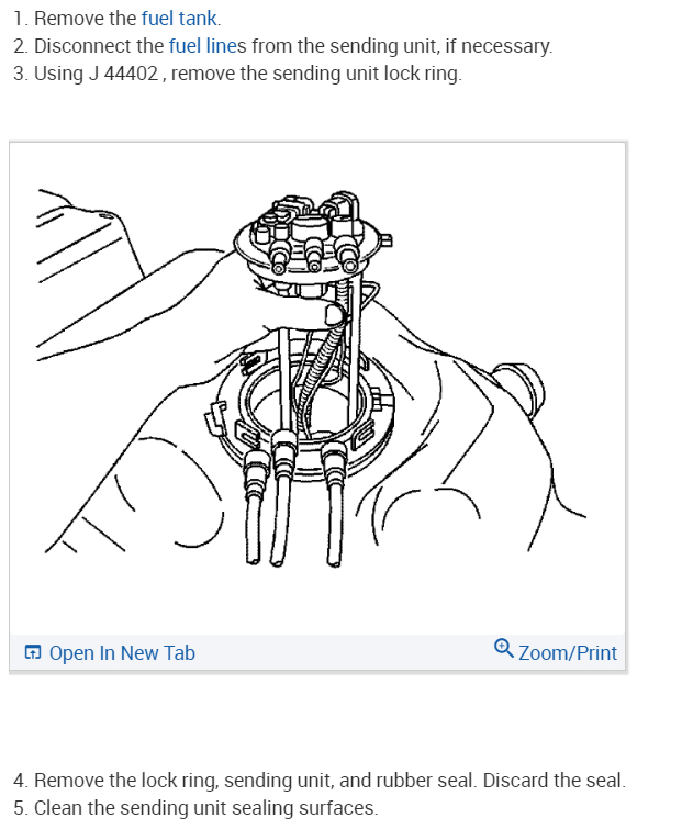

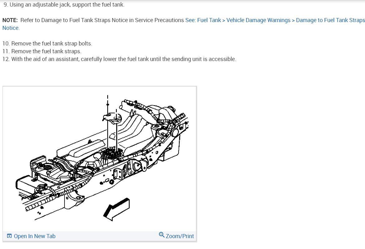

Here is how to change out the fuel pump if the pressure turns out low. Check out the images (below). Please let us know what happens.
