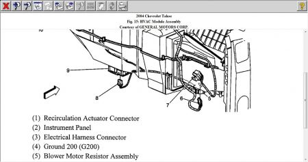

GLENN BOWERS
thanks, both these problems started at the same time are they interconnected? also is the motor resistor changeable from under the hood. Thaks you very much.
Nov 17, 2019 at 2:36 AM (Merged)
  • 75,992 POSTS
The BMR Its on the HVAC module see item no. 5 below
https://images.2carpros.com/forum/automotive_pictures/12900_bmr_2.jpg

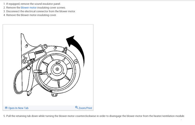

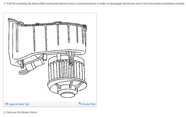

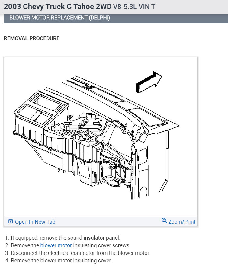

It sounds like you may have a blower motor that is going out, when the air is not blowing can you hear the blower motor working? Can you please shoot a quick video with your phone so we can see what's going on? that would be great. You can upload it here with your response.
Here is a guide to help walk you through the replacement with instructions in the diagrams below to show you on your car:
https://www.2carpros.com/articles/blower-fan-motor-works-on-high-speed-only

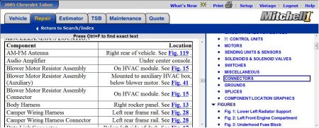

DANNYK
  • 6 POSTS
only the hi speed works on my front blower motor. speed 1 to 4 are inoperatable.. what is wrong
Nov 17, 2019 at 2:38 AM (Merged)
MATHIASO
  • 1,209 POSTS
The problem is the resistor. The resistor is on the HVAC module .
https://images.2carpros.com/forum/automotive_pictures/46384_12900_bmr_2_2.jpg
