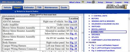

Will blow on 1 threw 4 will not blow on 5
Sunday, November 17th, 2019 AT 10:38 AM (Merged)
  • 75,992 POSTS
Inspect and test the blower motor resistor located -see below
https://www.2carpros.com/forum/automotive_pictures/12900_blower_motor_resistor_12.jpg
