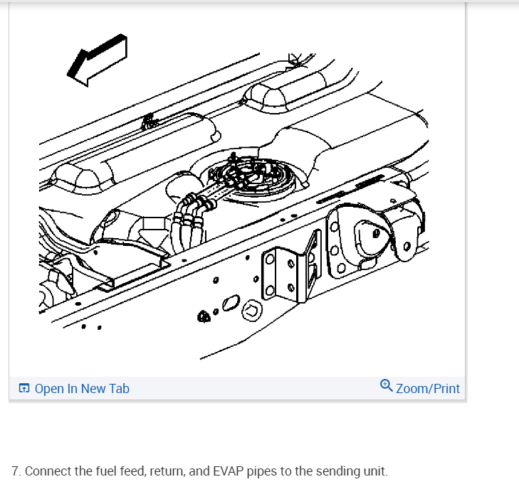

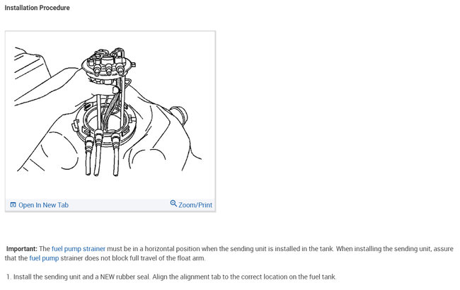

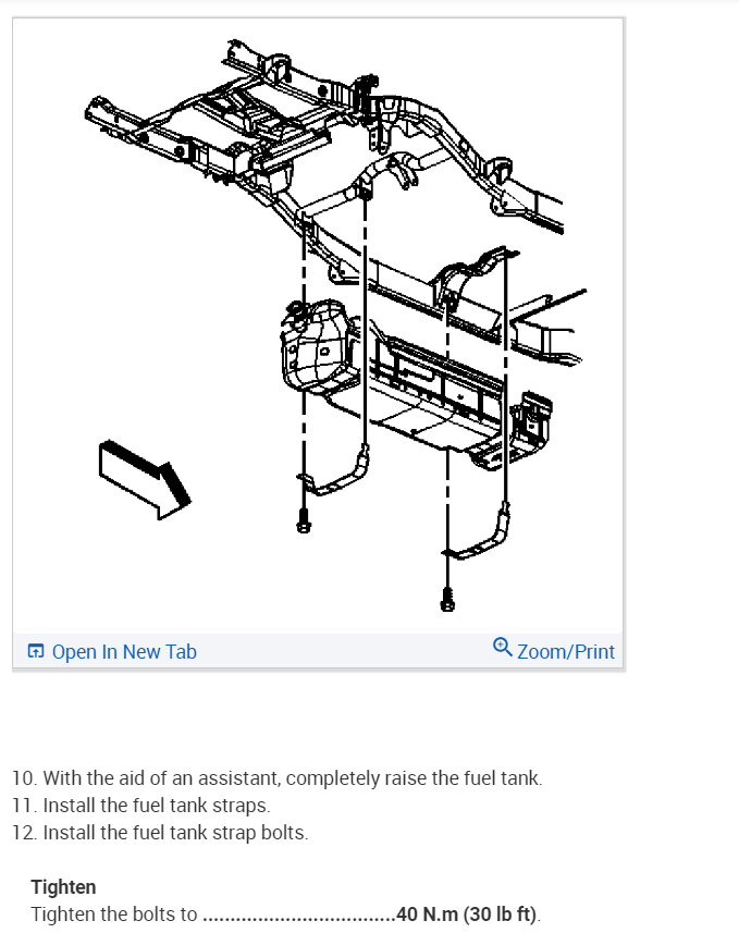

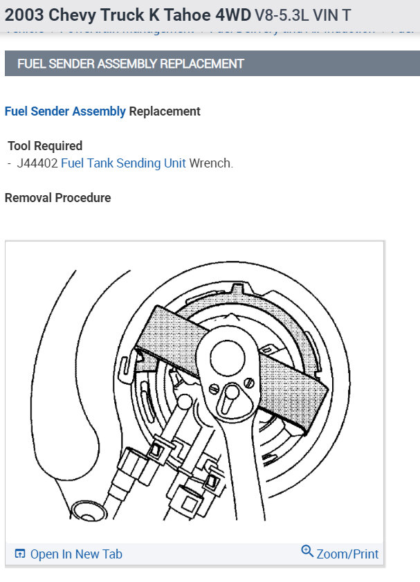

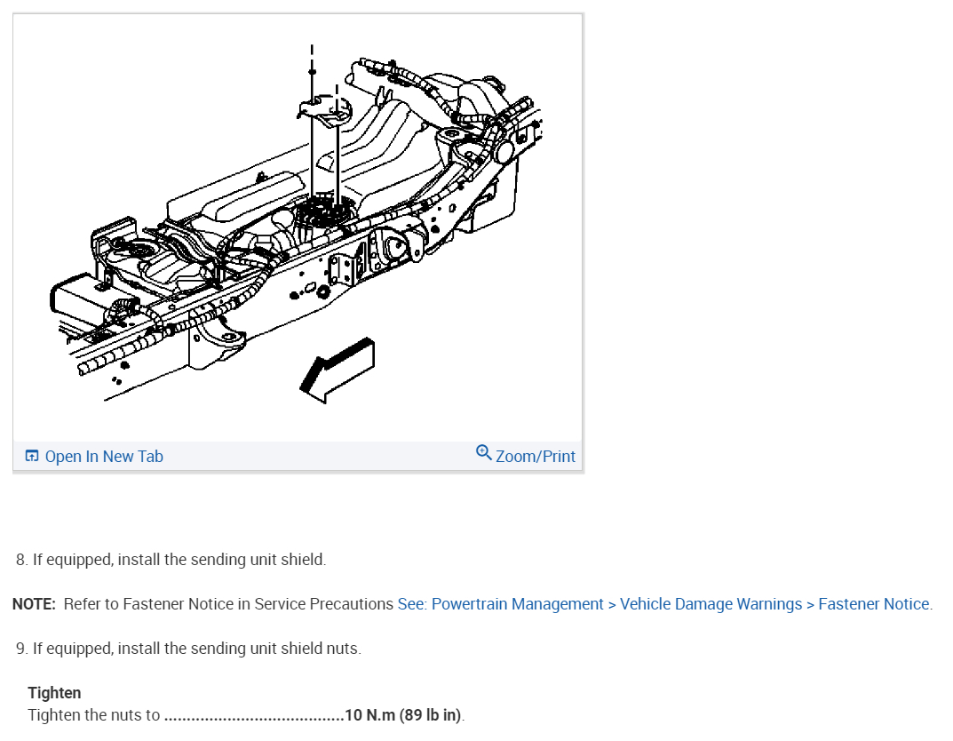

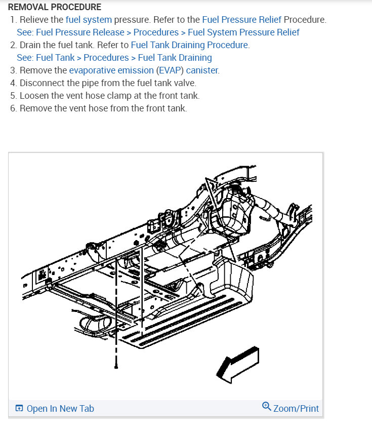

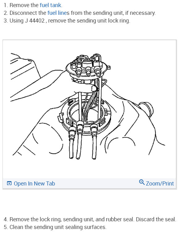

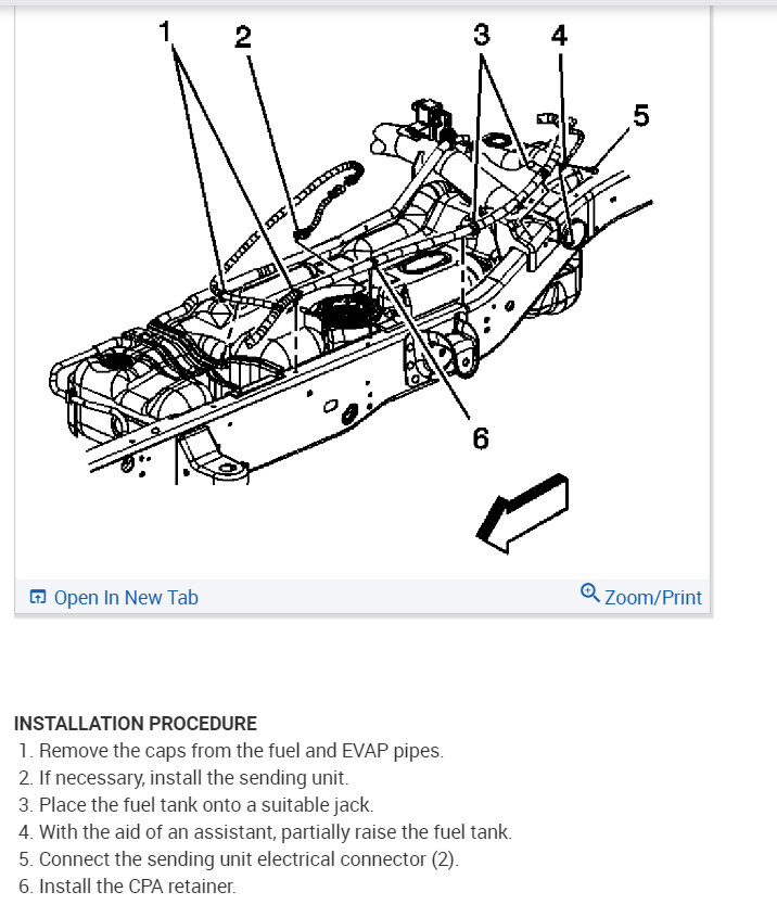

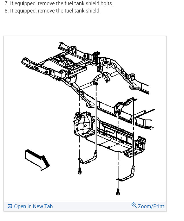

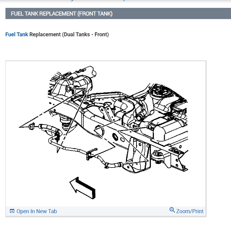

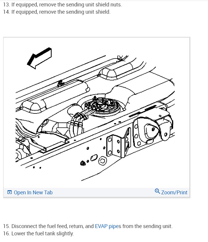

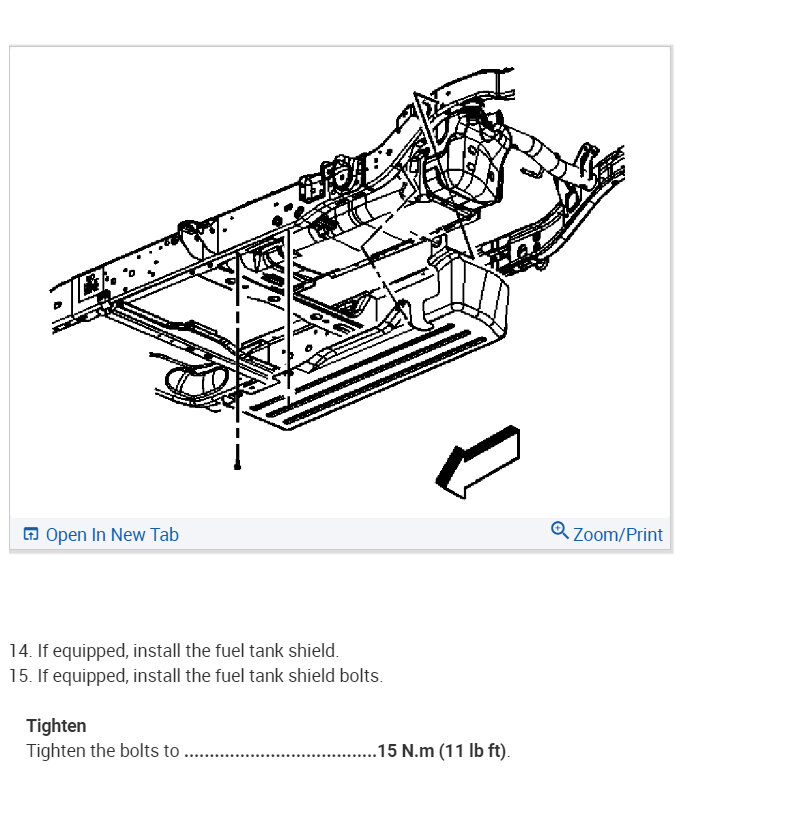

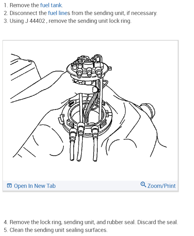

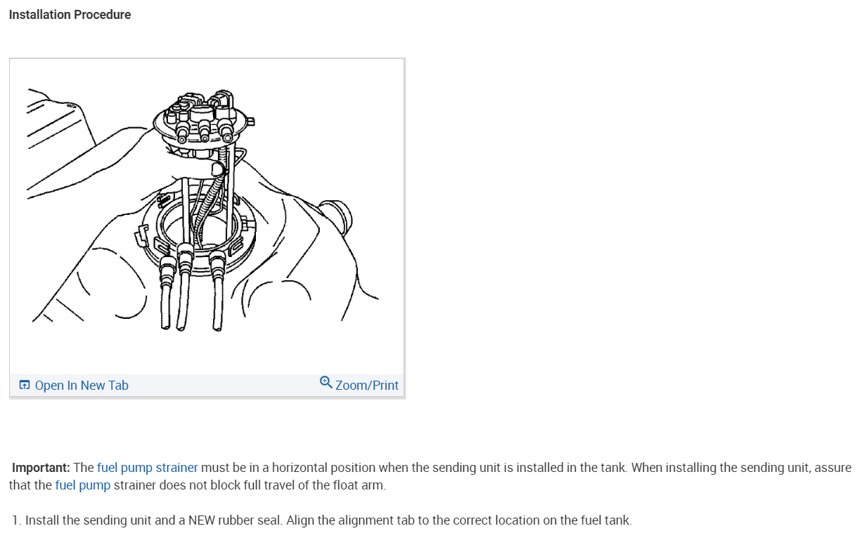

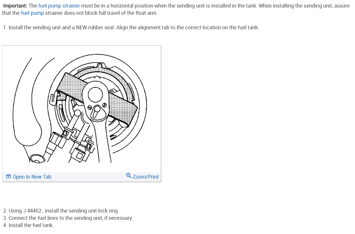

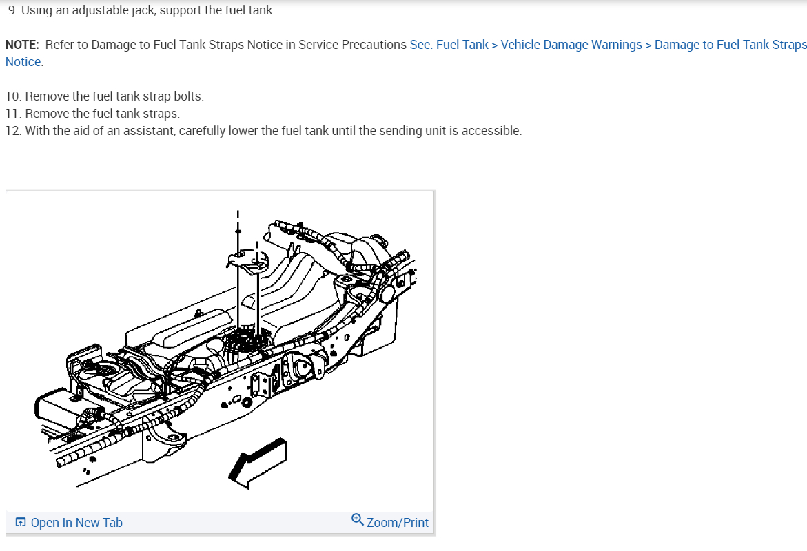

The Service Brakes Soon light will not make the car shut down FYI. This sounds like the fuel pump had gone bad or the instrument cluster is having issues. Here is a video that can help you find out what's going on.
https://www.youtube.com/watch?v=lXLJbuAZ4CE&t=29s
Here is how to change the fuel pump out in case you need it after watching the video. Check out the images (below). Please let us know what happens.
