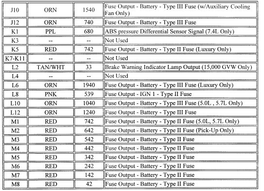

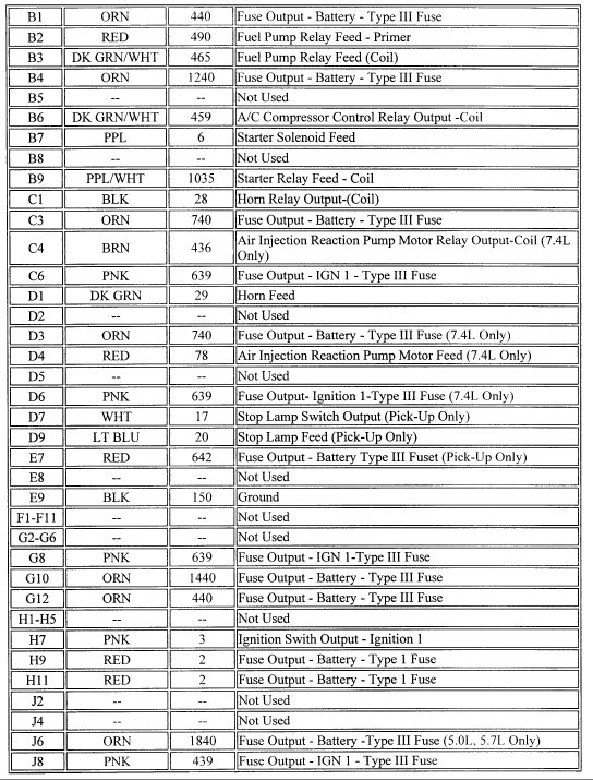

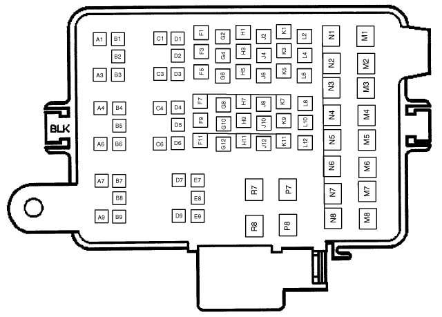

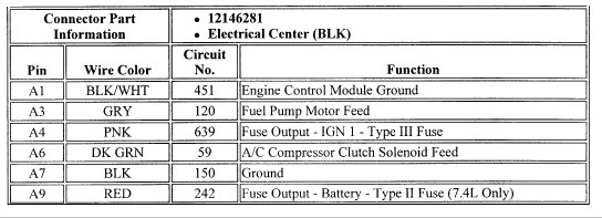

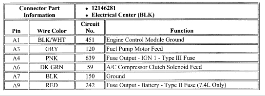

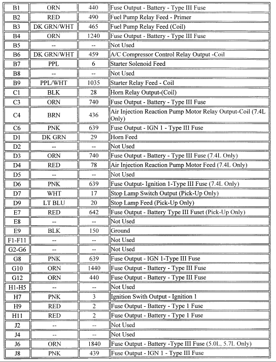

Was driving came to stop at red light when car shut off, no power at all no lights on dash or hazard lights. Have changed the fuel pump, the fuel filter, replaced the battery. The car will turn and sounds like it wants to start but never catches and starts. The lights on the dash do not light up either. Was thinking it might be the computer box or the electronic ignition. I am at a loss which way to go from here.
Wednesday, May 19th, 2021 AT 3:11 PM (Merged)
  • 109,872 POSTS
Hi and thanks for using 2CarPros. Com.
Since the only thing that works is the starter and nothing other lights up, I need you to check the main fuses located under the hood in the fuse block. I have attached pictures of it as well as what each fuses is for. Focus on the main battery fuses.

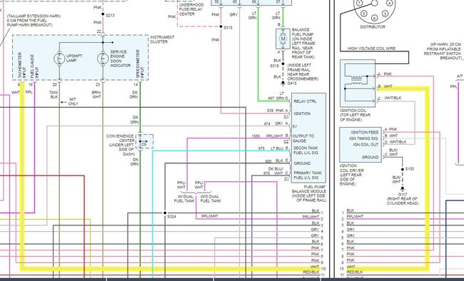

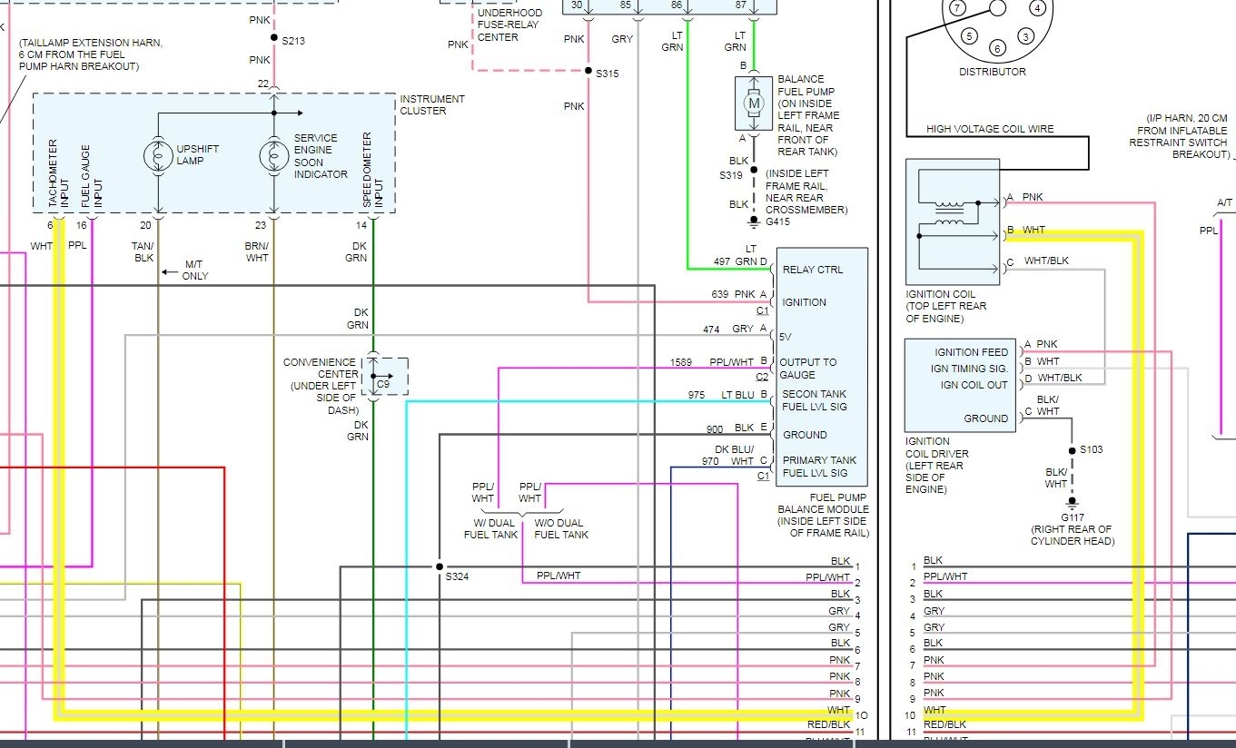

On a 3 prong ignition coil that fits a 99 chevy tahoe why is it that the pink wire is hot white wire hot and black and white wire hot when I turn the ignition on. Why does the pink wire make the other two hot?
Wednesday, May 19th, 2021 AT 3:12 PM (Merged)
KENW1
  • 213 POSTS
Thanks for visiting 2CarPros.
It's due to them all being tied in on the primary side of the coil.
The pink wire sends power to all of them and when the white & black wire from the coil driver grounds it collapses the primary field sending spark through the coil wire to the distributor and a pulse to the white wire for the tachometer. You can see how they are tied together in the diagram below.
If you have no spark check for pulse to ground on the white and black wire at the coil using a logic probe. It should flash while cranking. If not I'd suggest a scanner with live data to see if you have signal from the crank sensor.

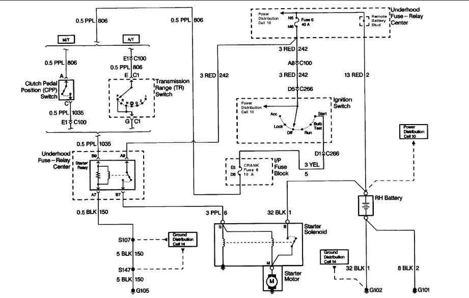

Truck had small, ineffective battery which sometimes my clock would be reset or if I tried to start too many times in too short a period would to start. Other day it would not start but was cranking, it would crank crank crank thunk. Turn key again, same thing. Almost started a few times. Ruined battery. Bought new full size battery and now get nothing, no crank or start. All inside lights work fine, radio etc, cleaned battery terminals, checked fuses, replaced ignition relay, all grounds are attached. Prior to this for three months I had a camshaft position error, (I think. It was cam-something) but it ran okay so did not worry about it. Is it possible I have fried the starter and if so, why am I not hearing a click? It is possible it is the original starter? Old but not too many miles on truck.
Wednesday, May 19th, 2021 AT 3:13 PM (Merged)
  • 52,797 POSTS
Good morning.
Yes, it is possible the starter is bad.
I would start by going under the truck to the starter motor and check the small purple wire attached to the solenoid. Make sure it has power when the key is in the start position.
If it does, the starter motor is bad.
If it does not we will need to do some electrical checks around the starter relay.
