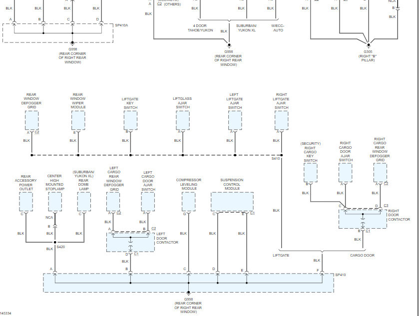

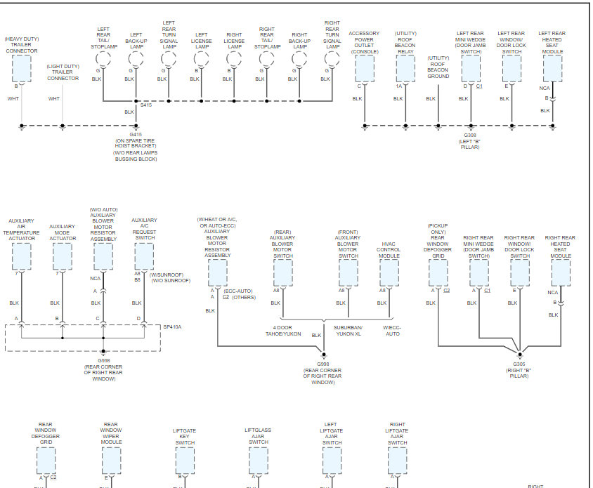

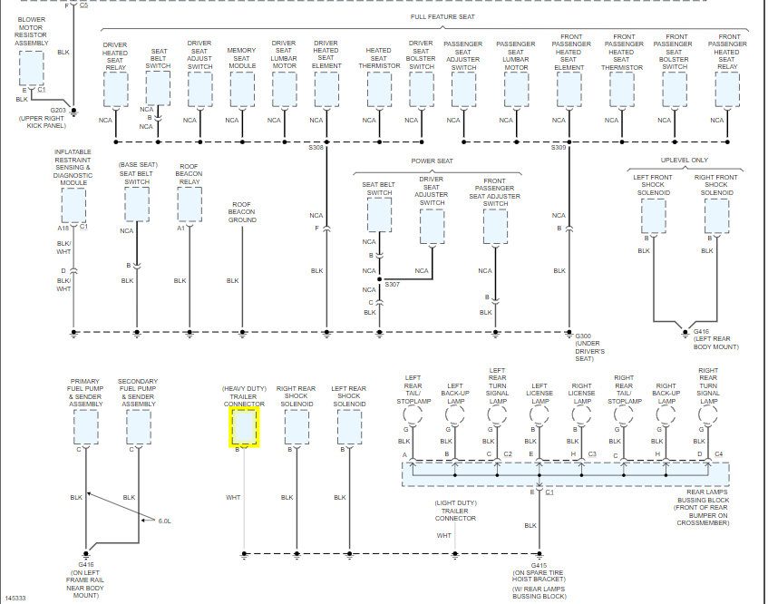

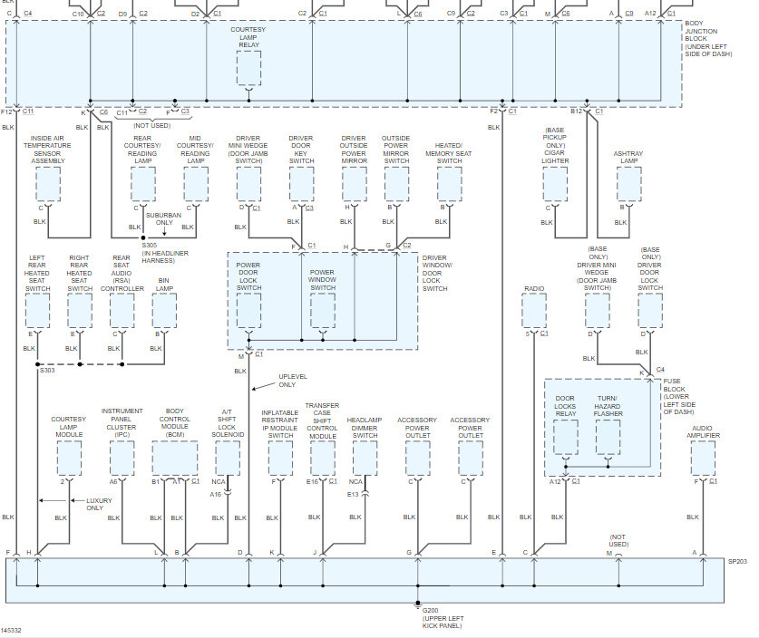

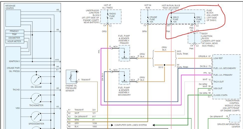

So I put in a transmission and drove it to where I did work once. Finished with transmission went to start turned key nothing. The radio comes on windows, light, but no dash. no fuel pump, no starter. change nss switch still nothing. please help.
May 19, 2021 at 3:10 PM (Merged)
  • CERTIFIED EXPERT
  • 110,176 POSTS

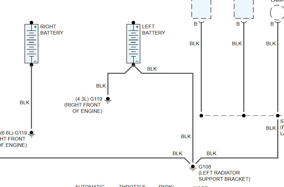

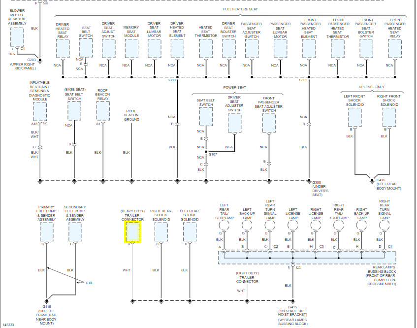

Is there power to the battery junction box? See pic 1 Also, confirm all grounds are secure and undamaged. See pic 2.
CABB1220
  • 11 POSTS

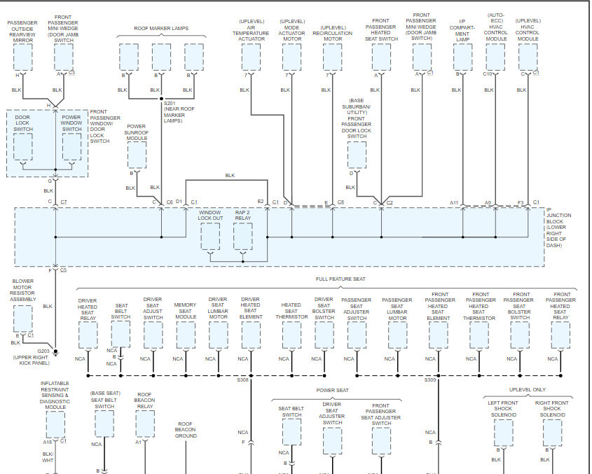

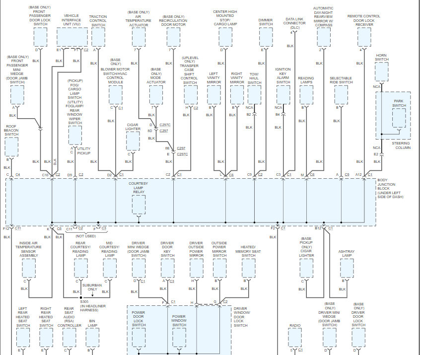

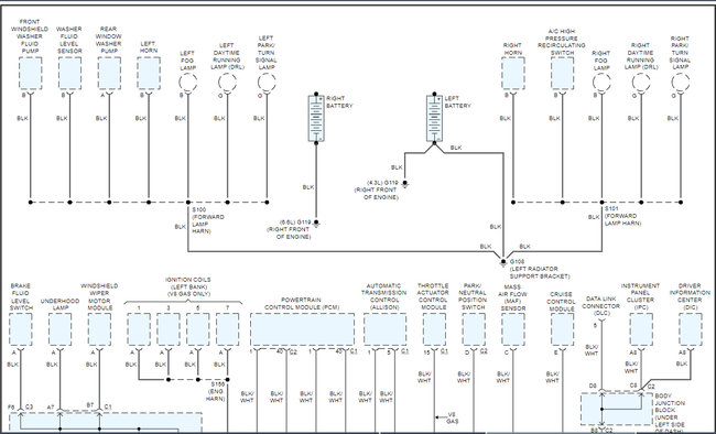

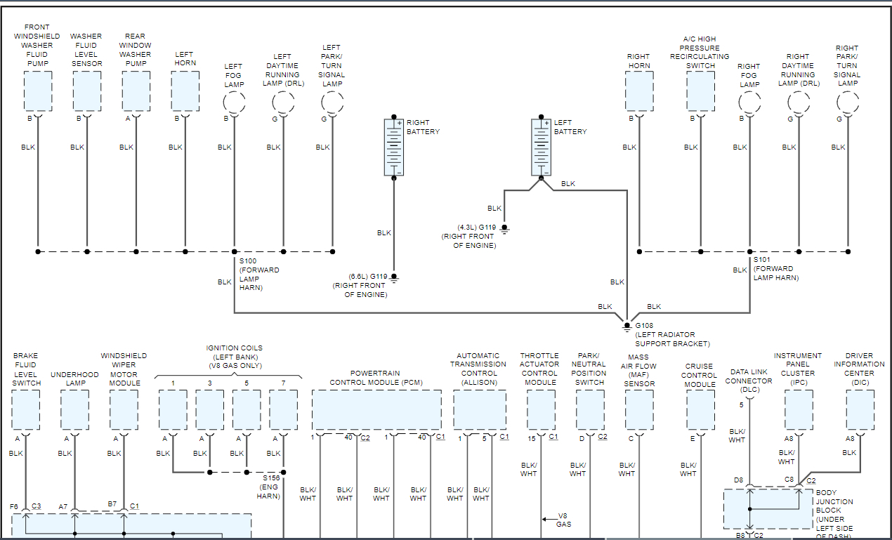

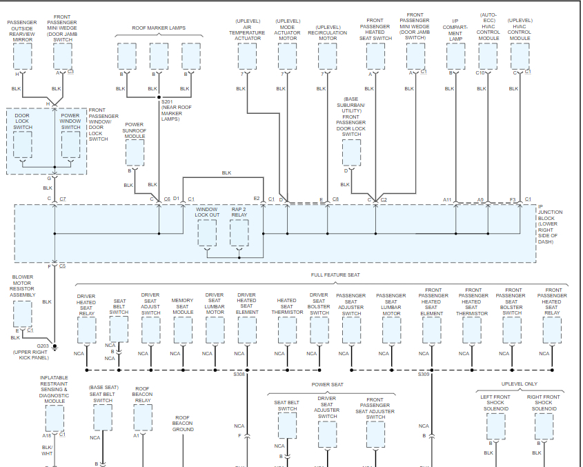

I have checked all of this. I was told there is a very small wire across the back of motor that is a ground but I don't know which one it is. there is a loom with a lot of wires.
  • CERTIFIED EXPERT
  • 110,176 POSTS

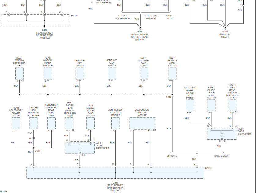

I have attached the ground schematics for the vehicle. I had to overlap them so you could follow them. Take a look through them to see if anything helps. I have to be honest. I'm not saying there isn't a ground wire issue, but for one small ground wire to cause all of these components to rail seems unlikely.

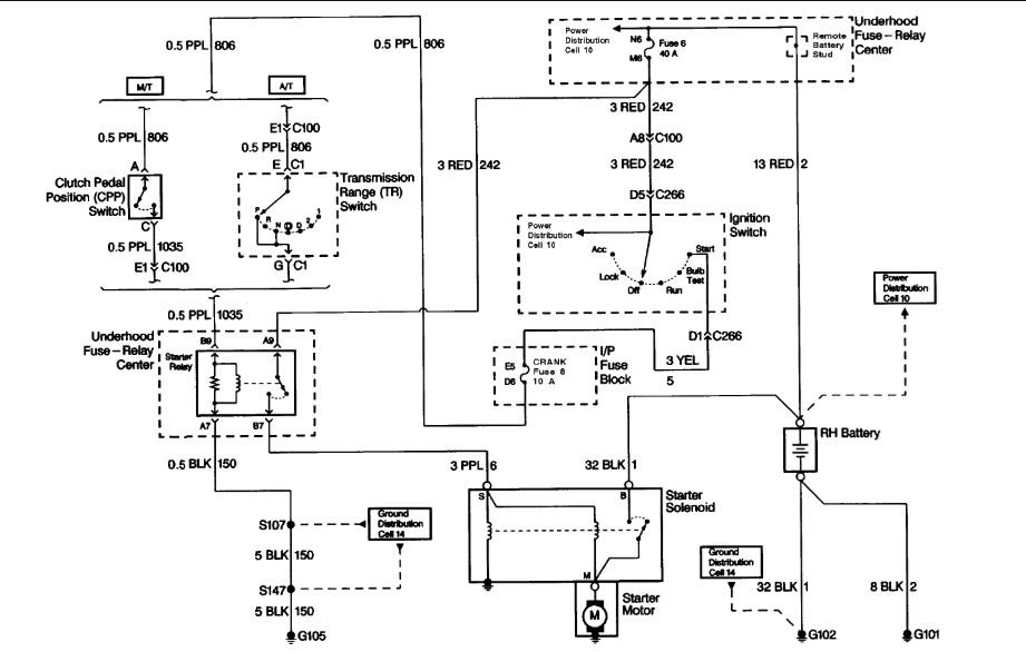

CABB1220
  • 11 POSTS
I did a jump wire on nss and the fuel pump came on starter relay clicked some one told me to bypass nss how do I do that just to see I've bought 2 of these this already.

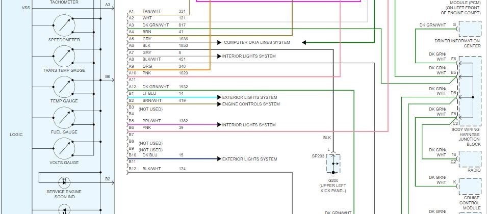

I checked very good to make sure didn't see anything. the PCM is getting power also. What about see the cluster is dead as well?

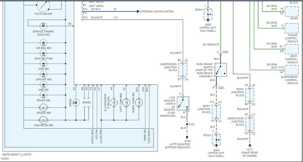

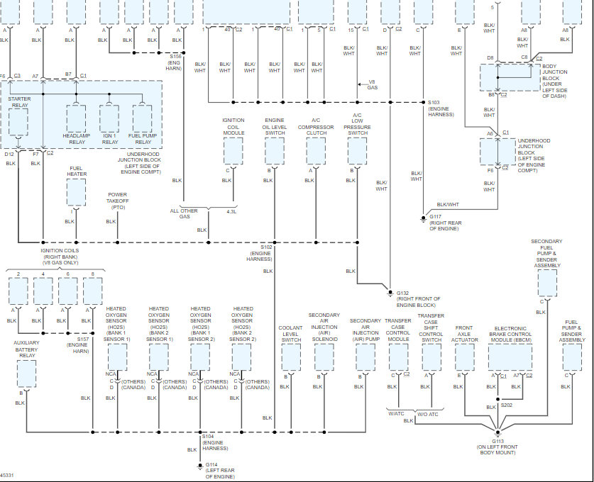

  • CERTIFIED EXPERT
  • 110,176 POSTS

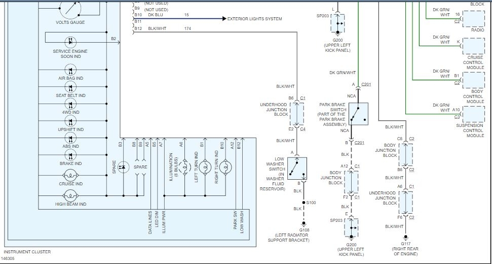

Here is a copy of the schematic for the instrument panel. See if there is anything here that helps. I overlapped the pics so you could follow them.
CABB1220
  • 11 POSTS
Got it. so I had checked all fuses but did not know all big fuses should be hot even when truck was off. the fuse didn't look blown but it was the ignition A fuse. replaced it SUV started right up. guys thanks a lot for all your help.

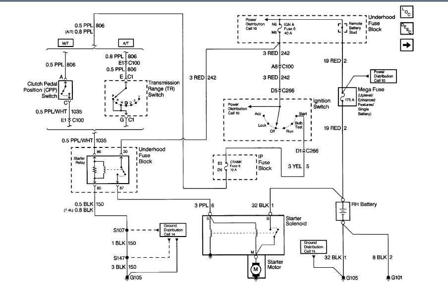

Recently changed water pump and now car will not start. Battery starter and alternator working. Lights come on. No crank no start.
May 19, 2021 at 3:11 PM (Merged)
  • CERTIFIED EXPERT
Good morning.
How did you test the starter if it does not crank? Did you cross the terminals on the starter?
Is the security or theft light on all the time with the key on?
This sounds like the starter is having problems or the battery needs to be load tested these guides can help us fix it.
and
Check out the diagrams (Below). Let us know what happens and please upload pictures or videos of the problem.

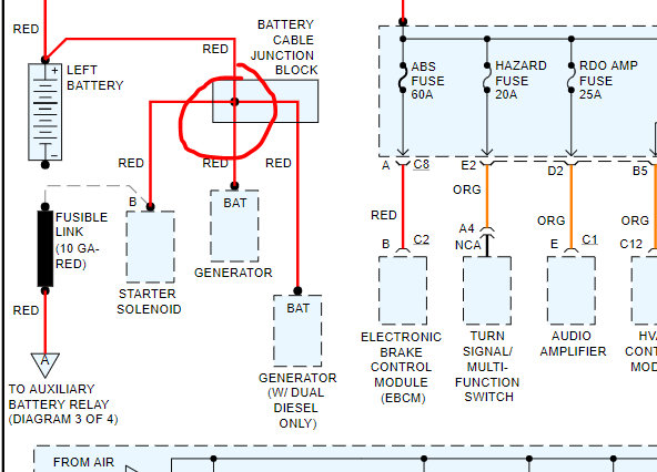

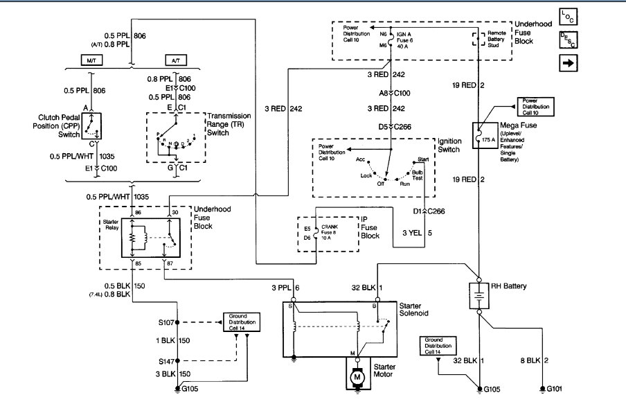

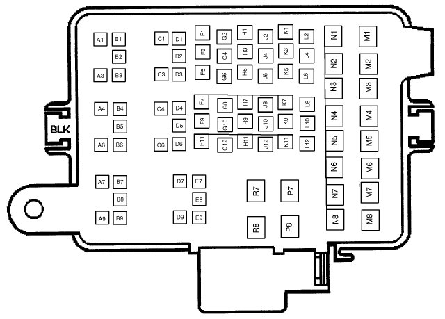

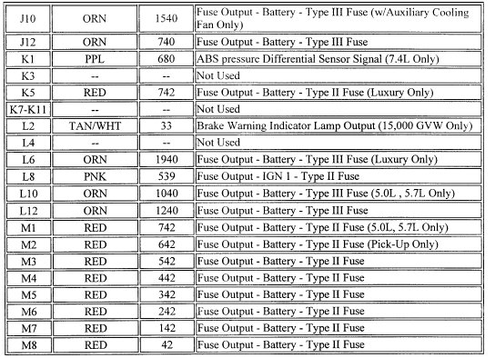

DBLAIR6899
Was driving came to stop at red light when car shut off, no power at all no lights on dash or hazard lights. Have changed the fuel pump, the fuel filter, replaced the battery. The car will turn and sounds like it wants to start but never catches and starts. The lights on the dash do not light up either. Was thinking it might be the computer box or the electronic ignition. I am at a loss which way to go from here.

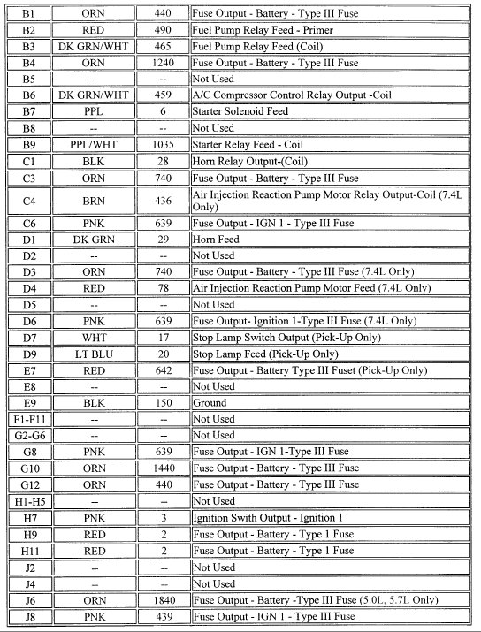

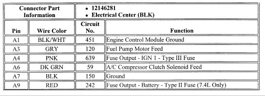

  • CERTIFIED EXPERT
  • 110,176 POSTS
Since the only thing that works is the starter and nothing other lights up, I need you to check the main fuses located under the hood in the fuse block. I have attached pictures of it as well as what each fuses is for. Focus on the main battery fuses.

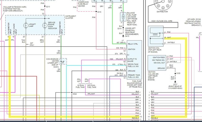

On a 3 prong ignition coil that fits a 99 chevy tahoe why is it that the pink wire is hot white wire hot and black and white wire hot when i turn the ignition on. Why does the pink wire make the other two hot?
May 19, 2021 at 3:12 PM (Merged)
KENW1
  • CERTIFIED EXPERT
  • 213 POSTS
Thanks for visiting 2CarPros.
It's due to them all being tied in on the primary side of the coil.
The pink wire sends power to all of them and when the white & black wire from the coil driver grounds it collapses the primary field sending spark through the coil wire to the distributor and a pulse to the white wire for the tachometer. You can see how they are tied together in the diagram below.
If you have no spark check for pulse to ground on the white and black wire at the coil using a logic probe. It should flash while cranking. If not I'd suggest a scanner with live data to see if you have signal from the crank sensor.
