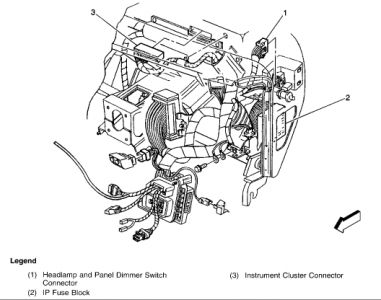

About a year ago my headlights stopped working. However, my running lights and high beams still worked fine. I didn't bother to look for a fix because I was just using my running lights.
Yesterday the running lights stopped working also. It seems like a fuse, but I can't find the fuses for the headlights.
Any ideas?

Are the low beams still inoperative? Do you have a test lamp?

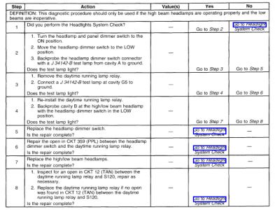

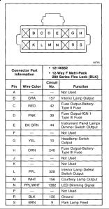

I have a test lamp. The only headlights that work are the high beams. No low beams or day time running lights. The day time running lights stopped working 2 days ago and the regular low beams over a year ago.
Saturday, February 27th, 2010 AT 12:29 PM
SCOTTY DEE
  • 592 POSTS
We are going to go with low beams inoperative diagnostic table.
http://www.2carpros.com/forum/automotive_pictures/470594_lowbeams_1.jpg
http://www.2carpros.com/forum/automotive_pictures/470594_dimmer_1.jpg
http://www.2carpros.com/forum/automotive_pictures/470594_connector_1.jpg
