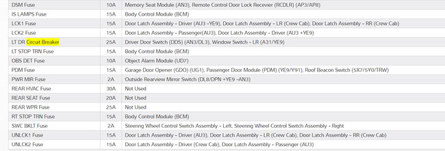

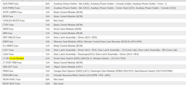

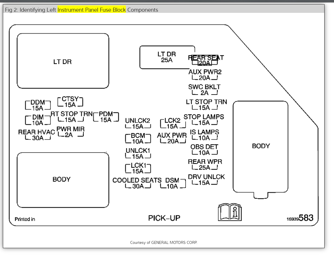

If there are problems on both sides then it sure is possible. lets check the fuses for power.

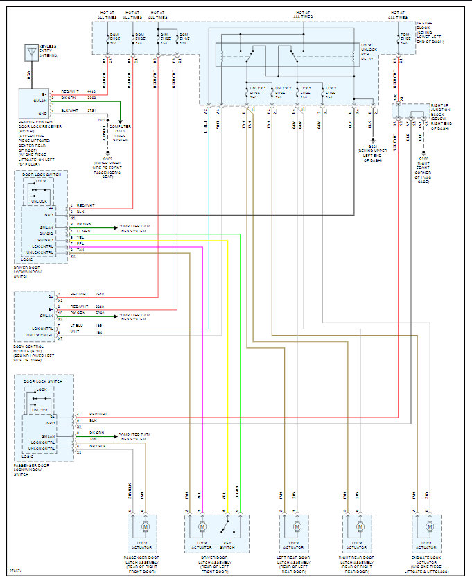

I am attaching the wiring diagram. I suspect we just have failing actuators as this was pretty common on these trucks. I would suggest testing power at the actuator and if there is, replace it. Let us know if you need help with this. here is a guide that should help:

Everything points to the body control module or the main switch in the drivers door which all circuits run through. I can't believe you would have 3 bad switches or 3 bad actuators or a combination there of. My cut and paste is down, but if you have access to a fax I can send you a wiring diagram.
Sep 25, 2020 at 3:22 AM (Merged)
JAMES W.
  • 2,394 POSTS
Mike, there are 3 different lock systems used in your suburban. One is ruled out because you have remote entry. Narrowing down the remaining two. Do you have a lock switch on the driver's door control that will disable the rear door lock systems? Also, on your keyless remote, if you push the button "once" does it unlock the driver's door only and have to push it again to unlock "all" the doors? It may not work that way now but, is that the way it is supposed to work?
The body control module is under the left side of the dash by the steering column.
Again, if you have access to a fax, I'll send you diagrams so you will know what I'm talking about. It may just be a relay and not the BC module.
One more thing, if you try to lock or unlock the right rear door from the driver's door, do you hear anything from the RR door?

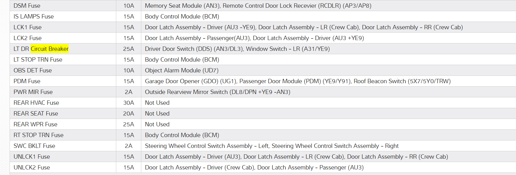

there are 4 fuses with this circuit and 1 jumper. go to autozone for electrical scematic. all contained of the left fuse panel. not sure where jumper is. check all.

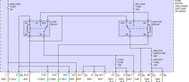

O. K. as I understand not able to lock doors via key or master control but relay clicks, horn etc.
Need OHM meter pull lock relay find terminal # 30 probe then, may need to unbolt fuse block, find two Gray/ black wires probably next to each other. Place other probe on one of them What does it read?
If open then wire faulty .
