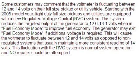

The head light flicker when i'm driving, almost like the
alternator is bad, this is the only thing that flickers.
The car is not that old, should the alternator be going out so soon?
also i was wondering if there were any other things i should look out for, concernin the electrical issue?

hi, does your voltmeter fluctuate with the headlamps? Did this issue just start or is it common. I found this bulletin.
https://images.2carpros.com/forum/automotive_pictures/170934_voltage_regulator_2.jpg
