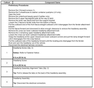

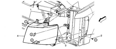

How do you remove the headlight assemble to replace the bulbs. I removed the 2 screws on top. This loosen the assemble but I could not get the unit free to hve access topt he plugs behind. Do you remove the entire front grill?

https://images.2carpros.com/forum/automotive_pictures/147643_headlight_2.jpg
https://images.2carpros.com/forum/automotive_pictures/147643_light_1.jpg
