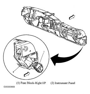

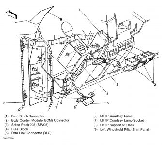

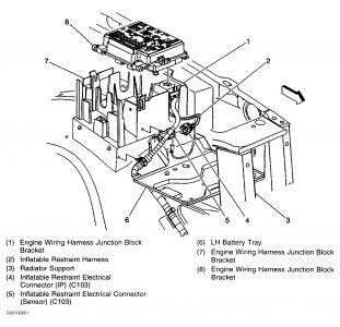

How does one get to the Center Instrument Panel Fuse Block?
Monday, March 2nd, 2009 AT 7:43 PM
3 Replies
ZACKMAN
MECHANIC
4,202 POSTS
I know three fuse blocks:
left of the instrument panel
right of dash
and under the hood.
SPONSORED LINKS
Monday, March 2nd, 2009 AT 11:41 PM
PETER THOMPSON
MEMBER
1 POST
Does the instrument panel have to be removed to access the one near the data link connnector?
Tuesday, March 3rd, 2009 AT 8:06 AM
ZACKMAN
MECHANIC
4,202 POSTS
No. You just need to get under the dash, look up a little bit to the left of the DLC connector, you'll see the fuse box.
