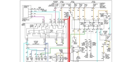

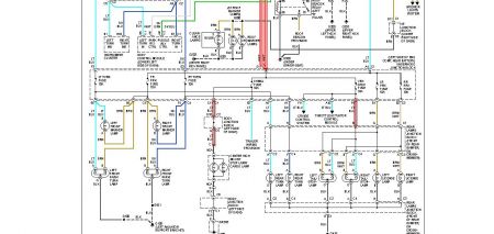

I have checked fuses, bulbs, replaced brake light switch, but brake lights still not working. The LED brake light works fine, as well as hazards, turn signals, running lights, etc... The cruise is not working, but it is my understanding, that without recognizing the ground through the brake lights it would not work. I have a factory installed tow hitch and have checked the system thoroughly. I have power in and out of the fuse in the box under the hood, additionally I am getting power to the trailer lights plug when brake is applied, but nothing at the brake lights. There has to be something that I am missing. Please help. Any information you can give me would be greatly appreciated.
Apr 21, 2010 at 8:00 AM
  • 75,992 POSTS
Hi DMoore97, Welcome to 2carpros and TY for the donation Lets do this find the rear lamps junction block front of rear bumper on crossmember have someone step on the brake and check for power at the light blue wire-no power here you have an open between here and the brake switch that's if the stop fuse 10amp is okay as for the trailer brake light check the ground circuit

It was a bad wiring harness. Thanks
