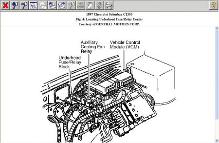

As per your PM-the fuel pump fuse is in the underhood fuse/relay block its a 20amp fuse-unable to determine where-pull all the 20amp and check and test it-
https://images.2carpros.com/forum/automotive_pictures/12900_fuse_block_3.jpg
Mar 30, 2008 at 7:18 PM
ARCHAGLR
  • 7 POSTS
[quote="rasmataz"]As per your PM-the fuel pump fuse is in the underhood fuse/relay block its a 20amp fuse-unable to determine where-pull all the 20amp and check and test it-
[ yes, and by the relay , there is a slot for 20 amp fuse that says fuel,,, but there is no metal connectors there and has never been a fuse there
