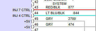

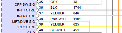

1) Challenged by 0300 misfire codes. Replaced, plugs, wires, injectors. 150-155 PSI in each cylinder.
2) 0300 remains and 0200 triggered.
3) Fuel pump continues to operate even though fuel pump relay was removed.
Thoughts?

yep, best thing on a misfire is to have a mechanic do it so he can scan the system and check things out as it can be basic problem, sensor, injector, multiple things. It is so you do not waste money on good parts. Auto parts are good for that, they do not know much so they sell you stuff they think it may be. the 200 code is an injector circuit problem which can be anything from a bad injector to a PCM or wiring issue like the harness.

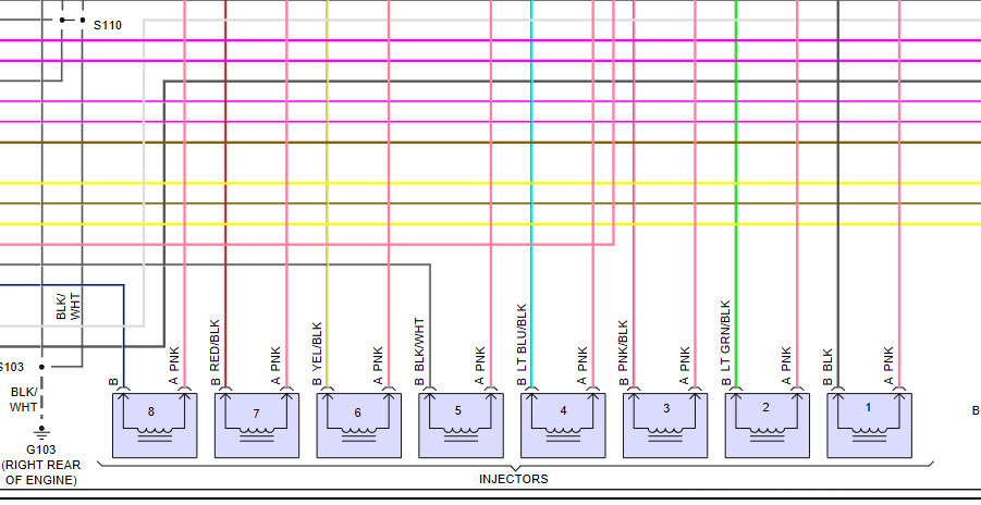

Thanks for your prompt reply. Previously, I verified that the number five plug and wire failed and all were replaced since wires were original and plugs had 95,000 miles on them. Resistance test on original injectors showed great disparity ranging from 15.6 - 12.2. Decided to replace them since flow was impaired on three and bench cleaning was not effective. Parts replacement was logic and sound. I just stumbled across your site. Do you folks provide wiring diagrams of the harness? Also, why would the fuel pump continue to operate after the relay is pulled? Does Chevrolet provide an alternate power source to the pump? If so, what could it be? Thanks again for your thoughts?

I did not send a diagram because of the VIN had to find out which it was first. the wires may have a connection right at back of engine under manifold so check there as the wires show going right back to PCM. you might check wire going to PCM on offending cylinder and see if it has a good connection normally under five ohms per wire. also make sure to check injector one and two fuses in fuse box under hood. numbers on PCM correspond with wires and are numbered on plastic connections at PCM.
