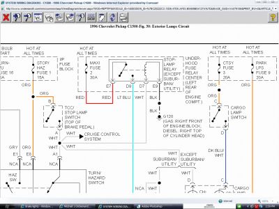

I press the brake pedal and the third light on the cab lights up. The fender lights have nothing. I have replaced the bulbs and installed a new brake switch on the pedal and the fuses in the fuse box are good. Am I missing another fuse panel or fusible link?

Under the hood there is a relay center and another fusebox there is 1 relay and 1 fuse in there for the stop lights...it's in the left rear of the engine compatment...
https://images.2carpros.com/forum/automotive_pictures/62217_96Silv_1.jpg

Check the underhood relay center and fuse box at the left rear of the engine compartment for the stop-light fuse and relay.
Conversation Summary
The owner of a Chevrolet Silverado says the cab third brake light works when the pedal is pressed, but the fender brake lights do not. Bulbs, the brake switch, and the known fuses have already been checked. The expert says there is another fuse box and relay center under the hood, at the left rear of the engine compartment, with one fuse and one relay for the stop lights.
