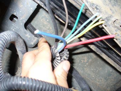

I need to re wire the 7 pin trailer wiring plug on my silverado. I have 8 wires for the harness and have figured out the turn signals, reverse and tail lights but what are the other 4 wires? The colors I have are: 3- 10ga; red, black,dark blue and 5- 16ga; brown, light bue, dark green, light green, yellow.

I really apreciate the info. Just to make sure I've got it right. The dark blue 10ga will go to the electric brake hook-up on the socket and the red 10ga. will go to the fused battery lead on the socket. I guess the only other question I would have is, in the wiring there is a light blue 16ga. wire that only has power with the brakes applied. I had assumed this would splice into a lead for the brake lights but, there is'nt one on the socket. What do I do with that wire? Thanks again.

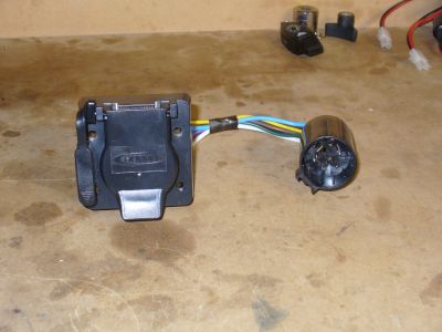

I am trying to wire in a n aftermarket Hopkinns kit #40955. Would it help if I uploaded a pic of the wires I am looking at?

Here are some pics of what I am looking at. I am planning to slice the wires to the wires off this plug. I hope this is helpful.

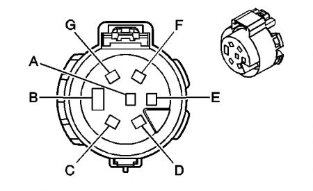

pretty good pictures,couldnt read the diagram at the bottom,was to small.here is the connector,maybe it will help.
https://images.2carpros.com/forum/automotive_pictures/147643_trailer_1.jpg
I havent had much time to really look into helping you,sorry but I've been busy.post back if this helps and I will assist.
