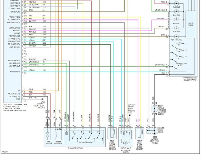

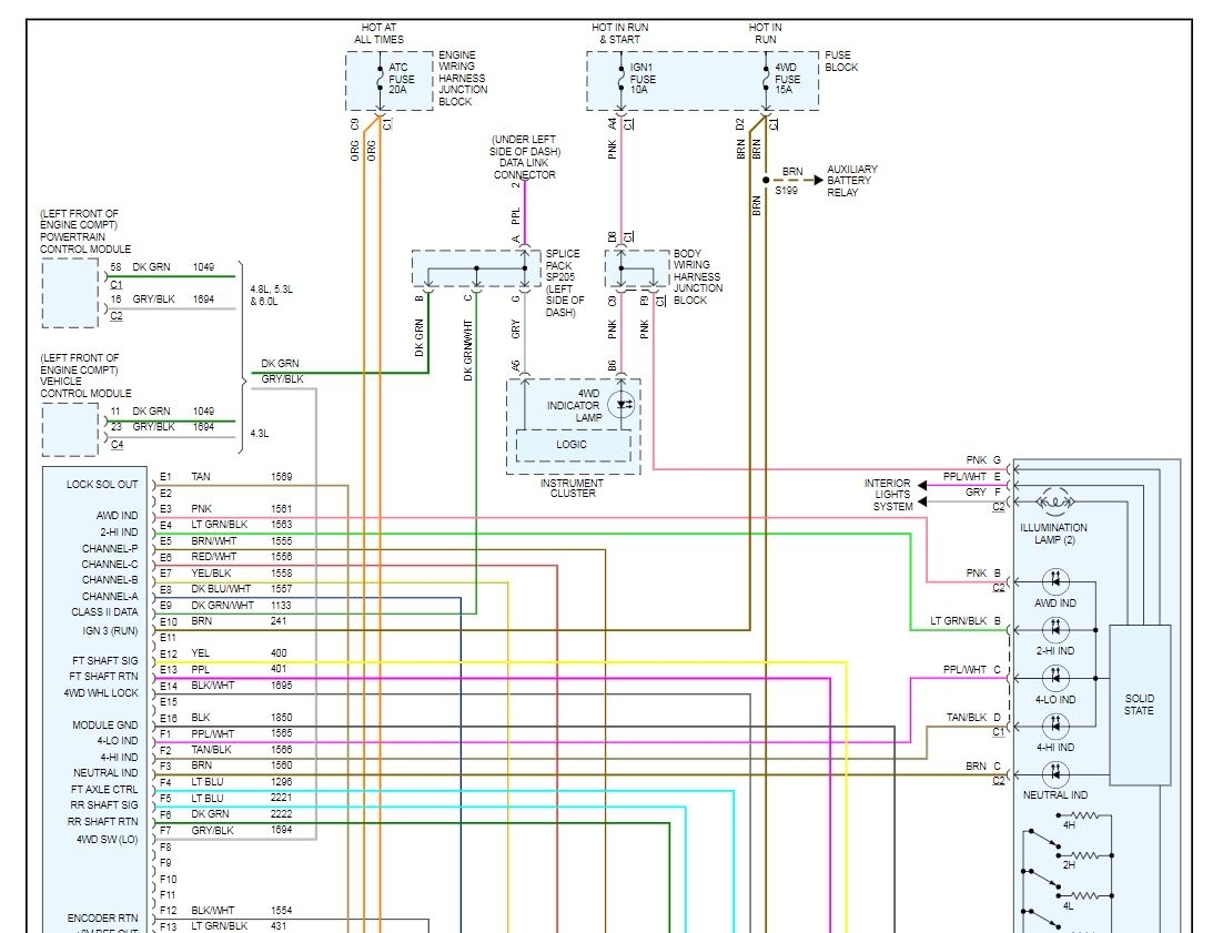

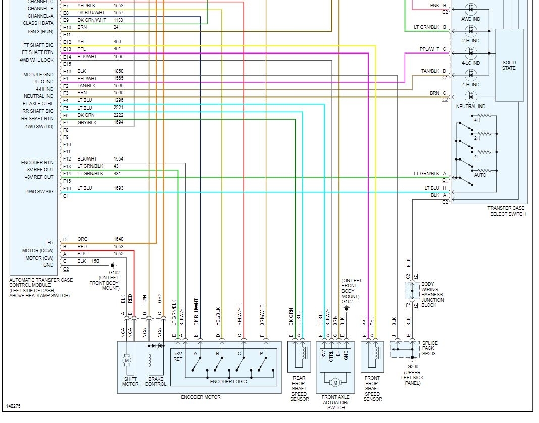

ALLEN
stuck in 4 lo 2000 will not come out, when i push 2 wheel drive buttonthe light does not light up at all 2000 silverado 1500
Jan 2, 2020 at 9:00 PM (Merged)
HMAC300
  • CAR REPAIR CONTRIBUTOR
  • 48,601 POSTS
I looked at teh schematics and most stuff seems ok. But there is a front speed sensor for the front prop shaft and see if that is connected well or the sensor may be damaged. It is on the case where the shaft comes out.. It may not be reading that the shaft isn't turning causing your problem. Or the wires are screwed up like a bad connection or were damaged..........

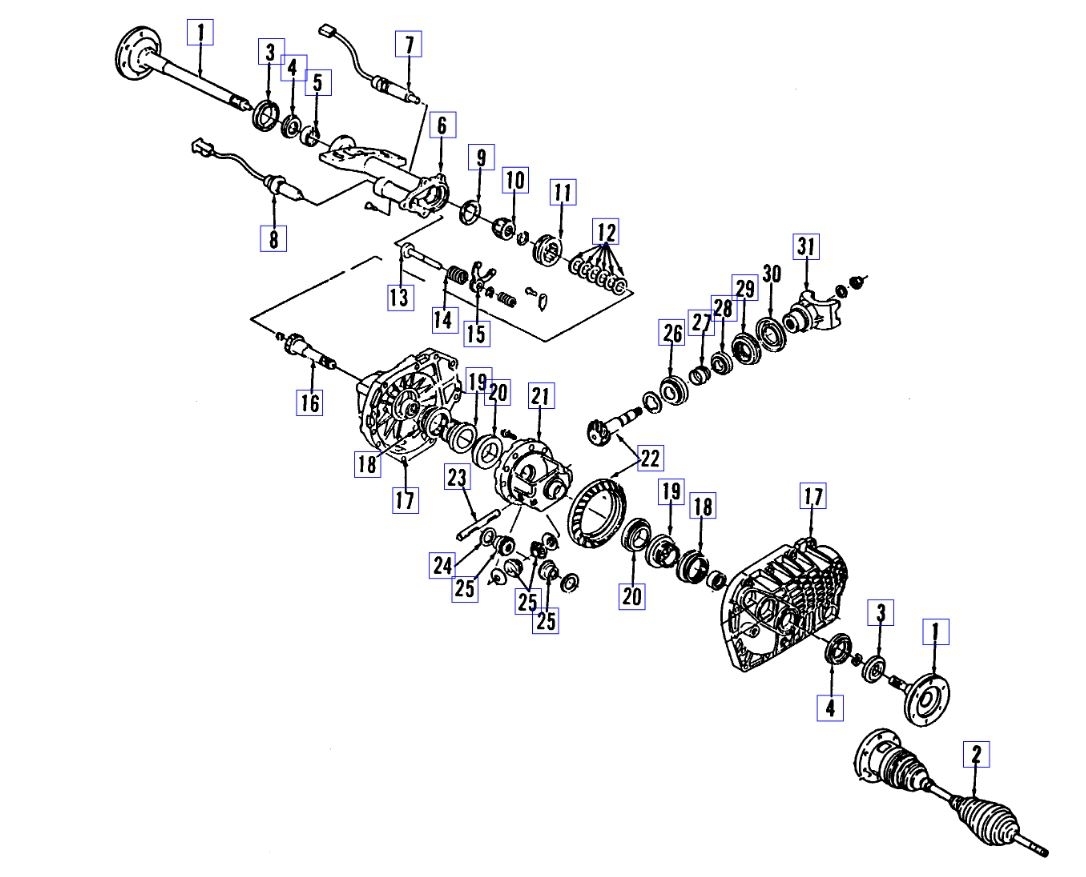

BFORBY1
Drive Train Axles Bearings problem
2000 Chevy Silverado V8 Four Wheel Drive Automatic
Have a 2000 Chevrolet Silverado 2500. The service 4 wheel drive light came on and the lights went out on the buttons on the dash. Took it to the dealer and they hooked it to their computer and they said I needed a transfer case motor. I replaced that and now the lights work. You can hear it switch the transfer case and it even gears it down when you put it in 4 low. When on the rack and you put it in 4 wheel drive the front tires will move but once on the ground the 4 wheel drive doesn't work. Any ideas what may need replaced now? No noise coming from the front differential while driving and it drives fine just no 4 wheel dig.
Jan 2, 2020 at 9:01 PM (Merged)
QUAGMIRE86
  • 98 POSTS
If the 4wheel drive is engaging without a load on it, the solenoid (on the front axle) seems to be engaging. It may be an issue with the shift/shaft fork (attached to front axle solenoid) may be worn enough where it is not pulling the gear far enough in to keep the front axle engaged when there is a load on it.You will need to check for power to the front differential solenoid to be sure its actually getting signal to lock the front diff
See the attachments below to see what wires to test
