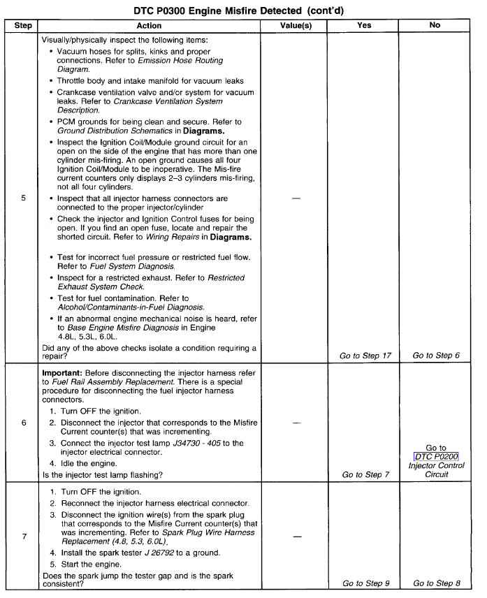

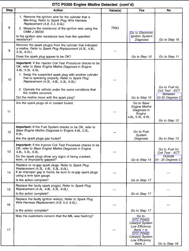

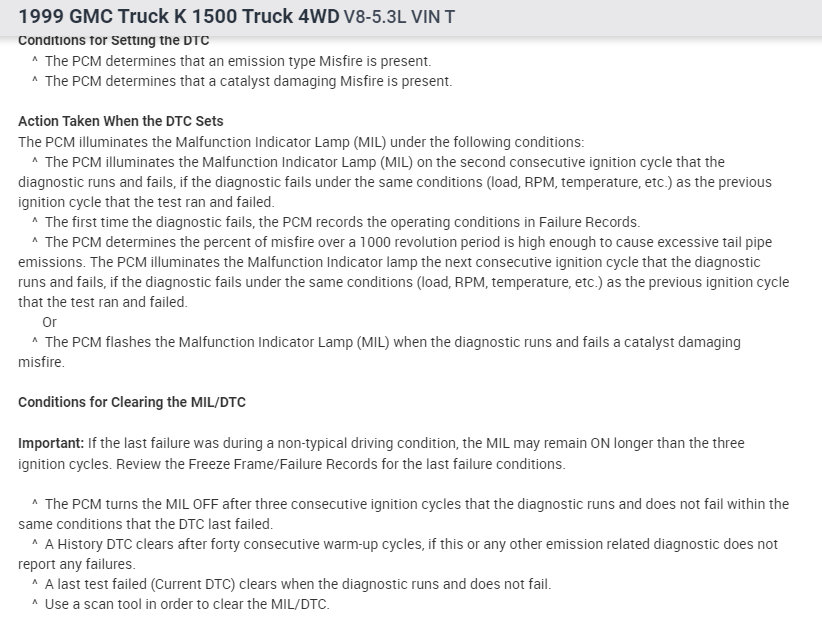

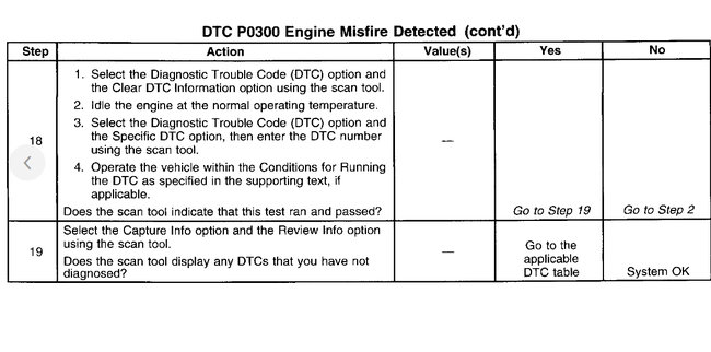

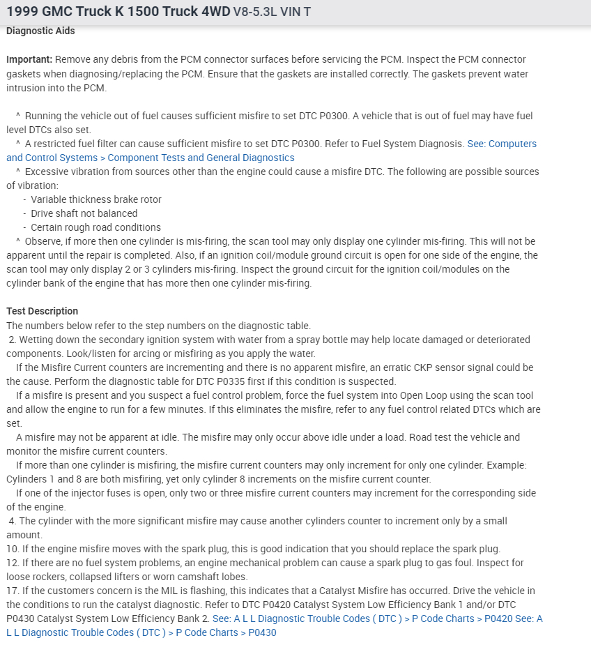

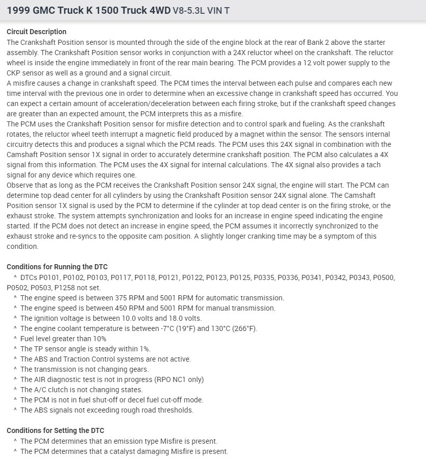

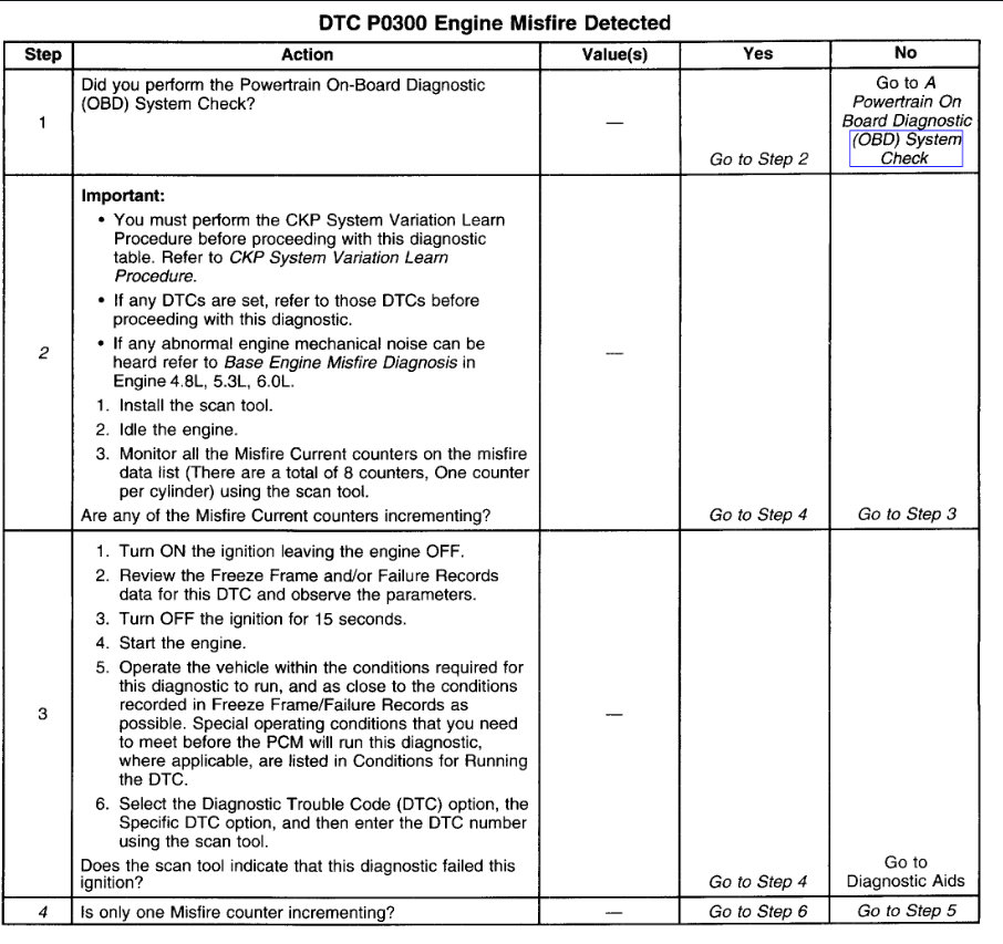

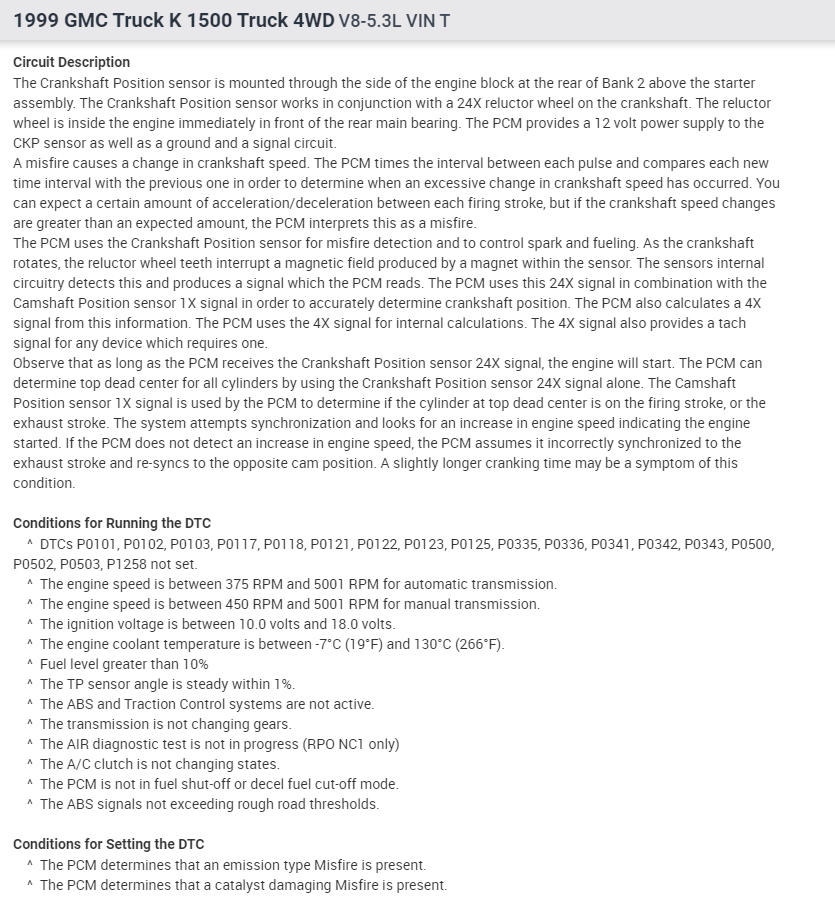

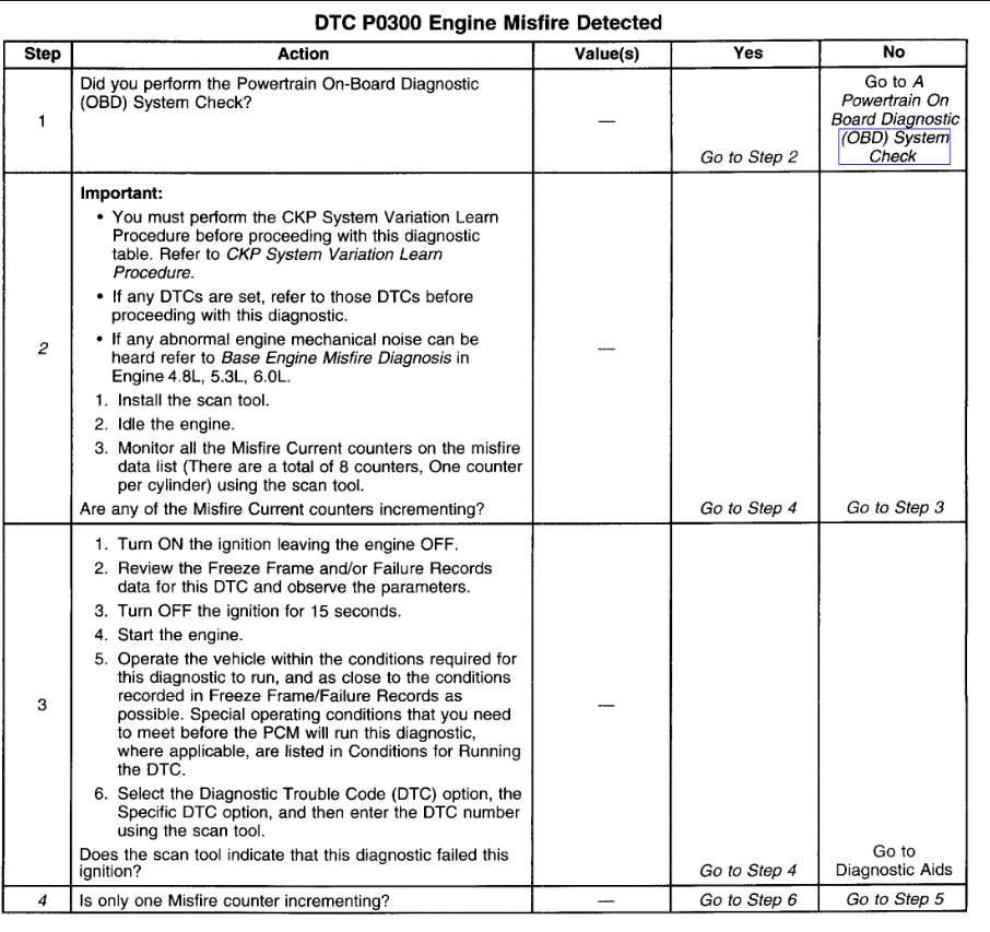

I have a 1999 GMC Sierra with a 5.3. The truck runs fine when you crank it and is idling, but if you give it throttle over 3,000 RPMs it starts to miss and throws a p0300 code. I did a tune up and replaced all fuel and ignition parts, even replaced some sensors MAF, crank sensor, TPS, temperature sensor, 02 sensors, just about everything. Truck has no vacuum leaks. Need help!
Friday, February 4th, 2022 AT 12:11 PM
SQM
  • 6,383 POSTS

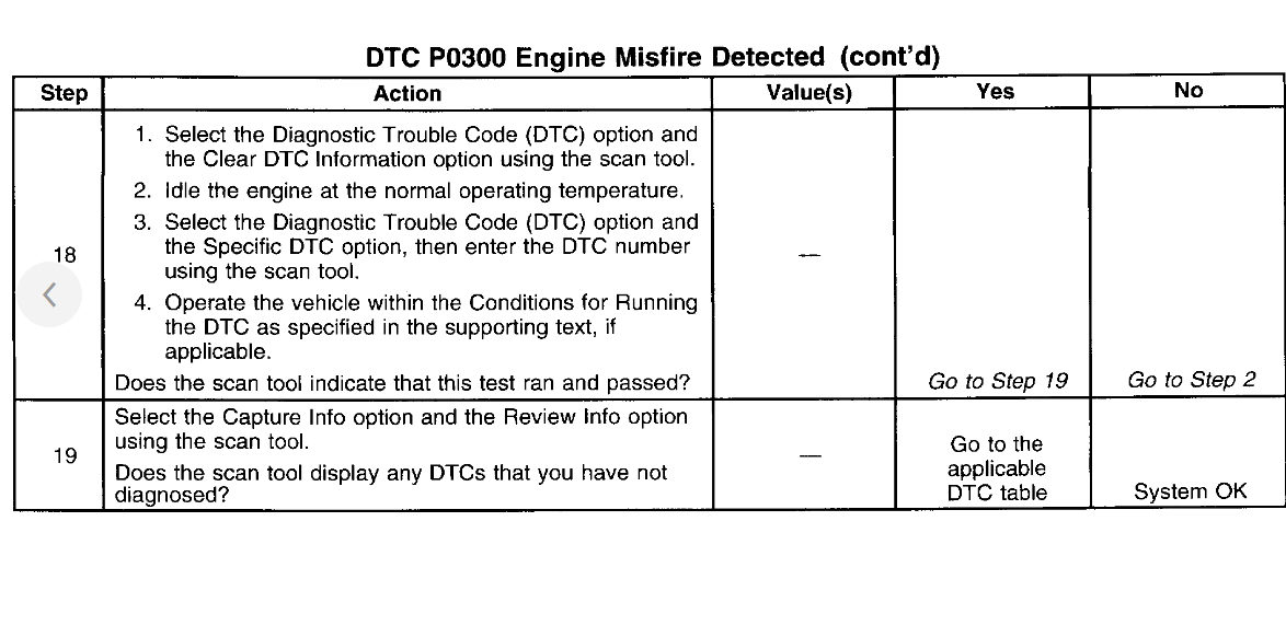

The P0300 code can be tricky to diagnose. It can be due to any number of reasons. It could be because of any ignition components as well as fuel issue. It can also be due to faulty PCM.
I have attached the trouble shooting steps for the code P0300 below.
Follow these steps as it can help you determine the issue.
