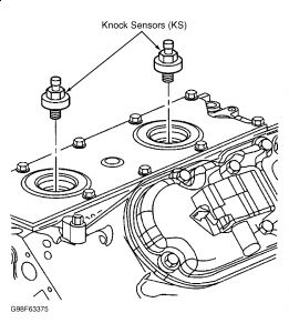

My check engine light is on a and a friend hooked up a reader and it says my knock sensor on bank 2 is bad. Where is this sensor located?

Hi there ,
See table for your engine and pic for view under valley cover.
Mark (mhpautos)

So you have to remove the intake to get to the sensors

Hi there,
For those engines with the sensor under the valley cover yes.
