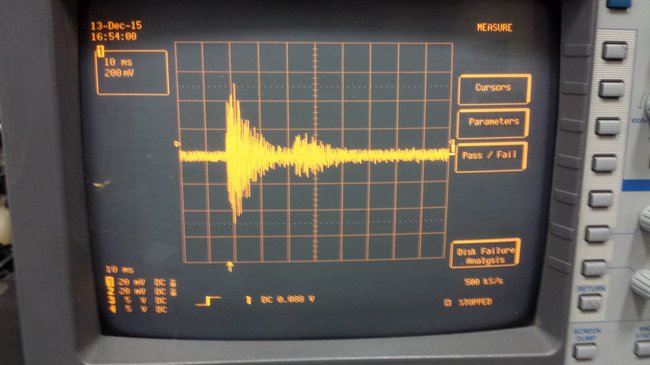

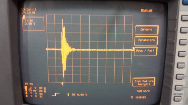

ENGINEER1
It's been a long time since anything was posted here, but I just went through the knock sensor fiasco and learned a lesson the hard way on my 2001 Suburban (225,000 miles). I purchased cheap sensors online for less than $20 for the pair. Installed them and had a SES light a couple days later. After much debate, I purchased a pair of OEM sensors for over $100. Before I put them in, I checked the $10 sensors with an oscilloscope (trace on the left below). The voltage setting was on 200 mV/division, so the signal shown is about 1 V peak-to-peak. I then removed the sensor and replaced them with the OEM parts torqued to the same value. I then did the same test with the oscilloscope (trace on the right). This time, however, the voltage setting is 2 V/division, so the signal is about 14 V peak-to-peak, more than 10 times higher than the cheap sensors. Both cheap sensors has about the same sensitivity (as did both OEM sensors), so this is very unlikely to be just two defective cheap sensors. They just do not have the performance of the OEM sensors. I am all for saving money when reasonable, but if you have to replace knock sensors, do yourself a favor and spring for OEM sensors.
