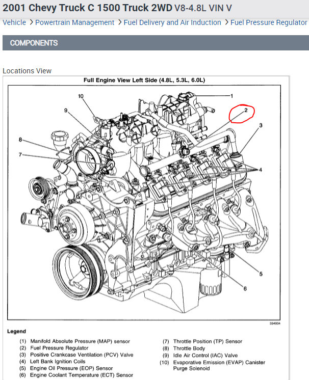

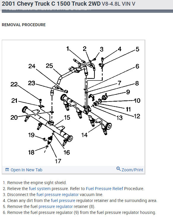

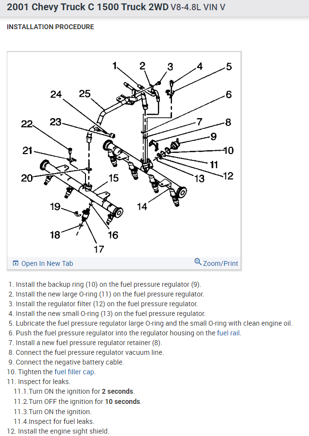

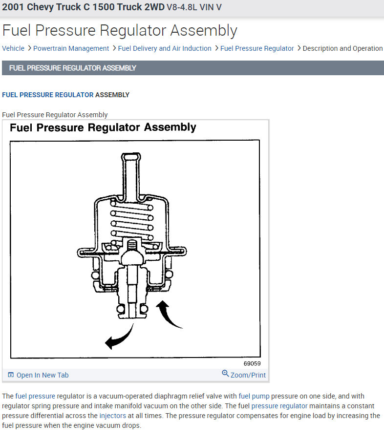

It does sounds like an issue with the fuel pressure regulator.
As you only have the issue when its cold, the internals of the regulator could stick when its cold but as everything warms up it gets free does not have any sticking issue.
You can do a fuel pressure test when its cold and another one when its warm.
That way you will be able to see if the pressure is lower when cold. And if it is then you will know that it is the regulator.
You should have 55-62 PSI of fuel pressure with the key on and engine off.
Here is a helpful video of how to test the fuel pressure:
https://youtu.be/aITQclp7zIE
I have attached the fuel pressure regulator diagrams for your reference.
