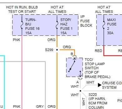

JDL
  • 16,098 POSTS
Does the high mount brake lamp work? If neither the high mount brake lamp or the lower brake lamps work, have to check stop lamp fuse and stop lamp switch.
Friday, February 26th, 2021 AT 10:17 AM (Merged)
REBEL_KID01
Wheres the stop lamp switch at?
JDL
  • 16,098 POSTS
The switch is activated by the brake pedal arm, follow the brake pedal arm, you should find the switch. In the diagram posted, did you check for voltage at the stop fuse?
REBEL_KID01
Iv already replaced that switch n still nothing
JDL
  • 16,098 POSTS
Did you check voltage to and from that switch, I gave you the wiring colors. Is the switch adjustable, anyway? Can you use a jumper on the proper wire colors and bypass the switch, just to see if brake lamps will work? Of course that proper wire color in diagram, on top. Has to have voltage, for the jumper to work.
LUCASJAKE
  • 1997 CHEVROLET SILVERADO
  • 6 CYL
  • 2WD
  • 106,000 MILES
My truck has tail lights and turn signals, but no brake lights. The fuse is ok. What else can I check? Where is the brake light switch?
Friday, February 26th, 2021 AT 10:18 AM (Merged)
JDL
  • 16,098 POSTS
https://www.2carpros.com/forum/automotive_pictures/170934_brake_switch_2.jpg
I found the above info for removal. Does the highmount brake lite work? The orange wire is feed to the brake switch, hot all the time. White wire is the feed coming from the brake switch to brake lites, that wire should be hot when you step on the brake.

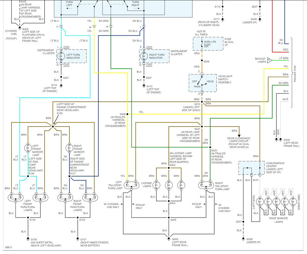

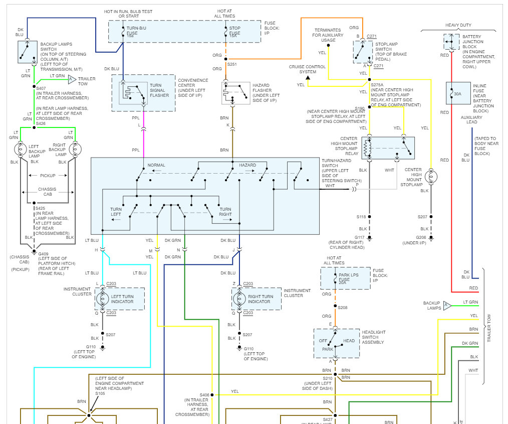

KEN L
  • MASTER CERTIFIED MECHANIC
  • 48,363 POSTS
It looks like the white wire goes to the high mount brake light relay, here are the wiring diagrams for the system so you can see how the brake light works. Also, here is a guide that might help as well:
https://www.2carpros.com/articles/brake-lights-not-working
