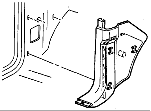

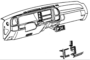

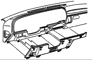

Would like to find out the proper steps for removal and replacement of a complete dashboard? I am removing the complete dash because it is cracked and unserviceable. Also, after being in storage there could and probably is some mouse nests behind which need to be removed?
Monday, July 27th, 2020 AT 10:07 AM (Merged)
  • 75,992 POSTS
Instrument panel assembly replacement
Remove or Disconnect
Negative battery cable(s).
Disable SIR system.
Three relay center bolts from inside wheel opening and set aside.
Bulkhead connector.
Two screws retaining Convenience Center to cowl.
Cruise control harness (if equipped).
Forward lamp harness.
Rear lamp harness.
SIR system harness.
Relay center.
Antenna lead-in.
Steering shaft bolt.
https://www.2carpros.com/forum/automotive_pictures/12900_p1_1.gif
Left and right hinge pillar trim panels.
Brake release handle from the cable.
Clip releases handle from cable.
https://www.2carpros.com/forum/automotive_pictures/12900_p2_1.gif
Four lower bolster screws.
Unsnap bolster.
Twist brake release cable to disengage.
Lap cooler hose.
Reaction plate assembly.
Tie bar.
8-way column connector.
48-way connector retainer to access two lower column nuts.
Shift cable (automatic transmission).
Steering column from the vehicle.
Shift levers.
Transfer case knob by pulling straight up.
Four wheel drive models must be in 4-LO range.
Manual transmission (if equipped).
https://www.2carpros.com/forum/automotive_pictures/12900_p3_1.gif
Left and right lower I/P pivot bolts.
https://www.2carpros.com/forum/automotive_pictures/12900_p4_1.gif
Center support screw.
Three upper I/P support screws.
I/P from the cowl.
Park brake release cable.
Electrical connectors (as necessary).
DERM
HVAC
22-way engine harness
Stoplamp switch
VSS calibrator module
Clutch or Brake release switches
Electronic accelerator (Diesel)
HVAC control cables (if equipped).
I/P from the vehicle.
At this point, I/P removal is complete. Reverse removal process
