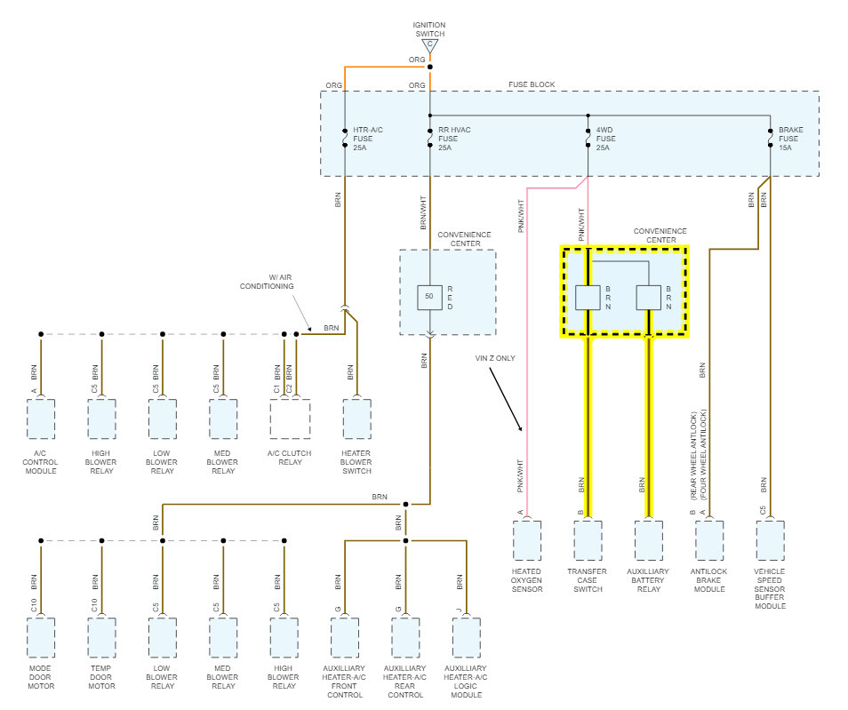

JLAYTON06
Hey, I'm new here. I have a 1994 k1500. 4wd fuse keeps blowing when I turn the key on. Recently a shop put a transmission in the truck. Can't keep a fuse in it because it literally pops the fuse when turning the key on.
Friday, December 31st, 2021 AT 10:31 AM
SQM
  • 6,383 POSTS
This is likely due to a short in the wiring. That is why the fuse blows as soon as you plug it in.
To find out the issue this will require you to trace the wire.
Here is a helpful guide on how to test wiring systems:
