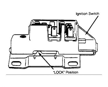

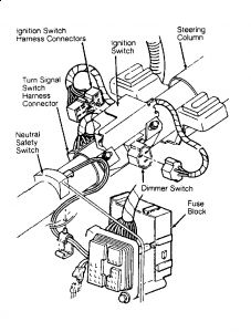

For now - the biggest thing we see for this is the linkage on the switch is out. . .. . .. . .you can test for sure by turning the key off and then moving the linkage. If it shuts off. . .. . ...then that is your problem.
I have attached the procedures for removal and installation and it does talk about ensuring the actuating rod is aligned with ignition switch.
IGNITION SWITCH
NOTE: It is not necessary to remove steering wheel. Ignition switch is mounted on top of steering column, near front of dash.
Removal
1. Remove steering column-to-dash panel bracket. Lower steering column. Remove ignition switch retaining screws. Place ignition switch lock cylinder in LOCK position.
2. If cylinder lock was removed, the actuating rod to the switch should be pulled up until there is a definite stop, then moved down one detent, which is the LOCK position. Disconnect electrical harness connectors. Remove ignition switch assembly. See Fig. 1.
NOTE: Use only specified screws. Using screws that are too long may prevent column from compressing under impact.
Fig. 1: Identifying Column Switches
Courtesy of GENERAL MOTORS CORP.
http://www.2carpros.com/forum/automotive_pictures/248015_1_187.jpg
Installation
Place ignition switch in LOCK position. See Fig. 2. Install ignition switch. Ensure actuating rod is aligned with ignition switch. To complete installation, reverse removal procedure.
Fig. 2: Identifying Ignition Switch LOCK Position
http://www.2carpros.com/forum/automotive_pictures/248015_2_123.jpg

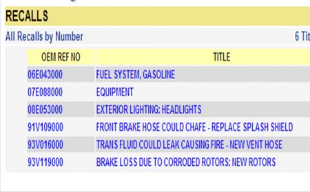

Also, it looks like you may have some recalls on your vehicle. The dealer may fix these for free. Please contact the dealer service department, give them the VIN number of your car and have them check on these to see if they apply to you.
http://www.2carpros.com/forum/automotive_pictures/248015_recalls_8.jpg

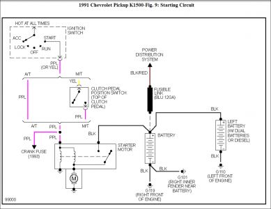

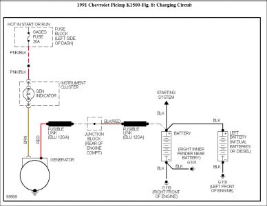

Here is the only info I have on this. . .. . ...the manual doesn't seem to give out too much on this vehicle for some reason.
My other thought is go to Auto Zone (AZ) or O'Reilly's (OR) and for FREE they can bring their tester out and check your battery and alternator. I am interested to see if your alternator is putting out anything odd.
http://www.2carpros.com/forum/automotive_pictures/248015_Picture1_98.jpg
http://www.2carpros.com/forum/automotive_pictures/248015_Picture2_63.jpg
