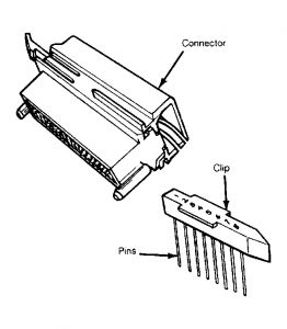

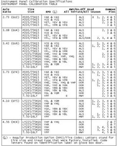

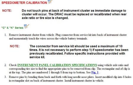

I had to replace the curcuitboard in my cluster panel and now my speedometer is 20 mph off. How do I recalibrate or set it back to normal?

FIG. 1
