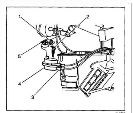

my truck has stopped blowing heat out the lower vent. It does work for defrost and mid vent just not to the feet. What could cause this?
Nov 28, 2008 at 5:49 AM
BLUELIGHTNIN6
  • 16,542 POSTS

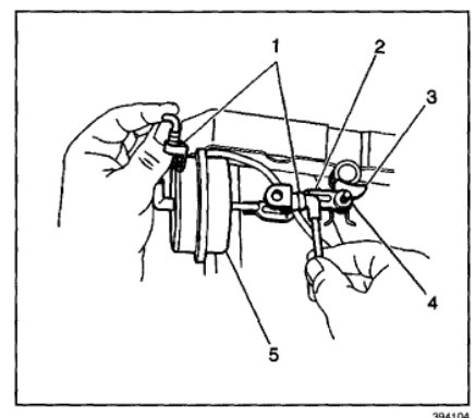

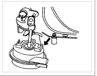

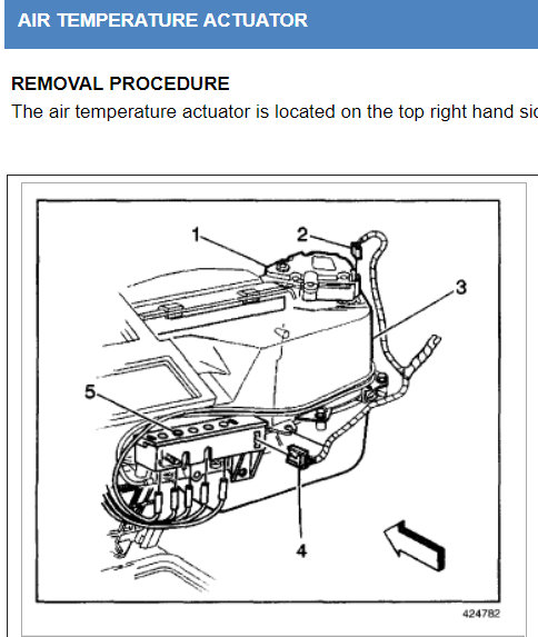

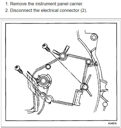

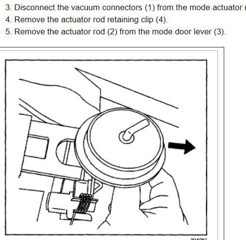

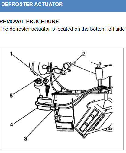

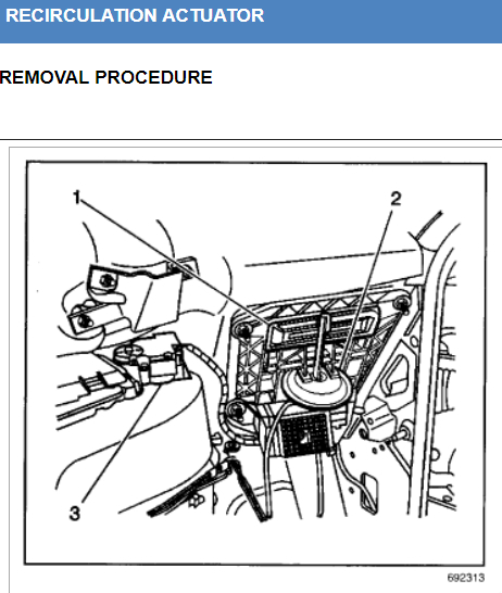

When you move the control switch to the lower vents, what does the air do? Does it still blow out of the upper vents? If so, you need to check for an actuator that is not working this guide can help see what's going on with instructions for your truck in the diagrams below.

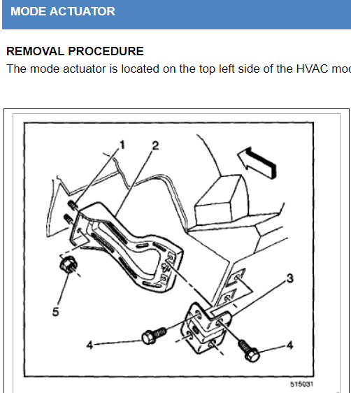

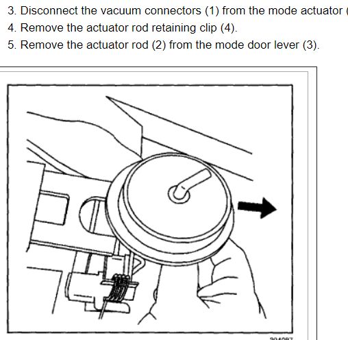

Ckeck the vacuum operated controls on the heater box under the dash. If you find on that doesn't move whrn you change positions on the selector switch, try moving it by hand. If this manual movement blows air to the floor, check for vacuum at this actuator. If no vacuum, the selector switch is bad. If you have vacuum, the actuator is bad

First check your fuses there is an electic motor which changes the doors inside the dash to control where the air is sent, if all fuses are good the blend door actuator is most likely the cause a replacement runs about $50.00 or so and is available aftermarket at most parts stores.

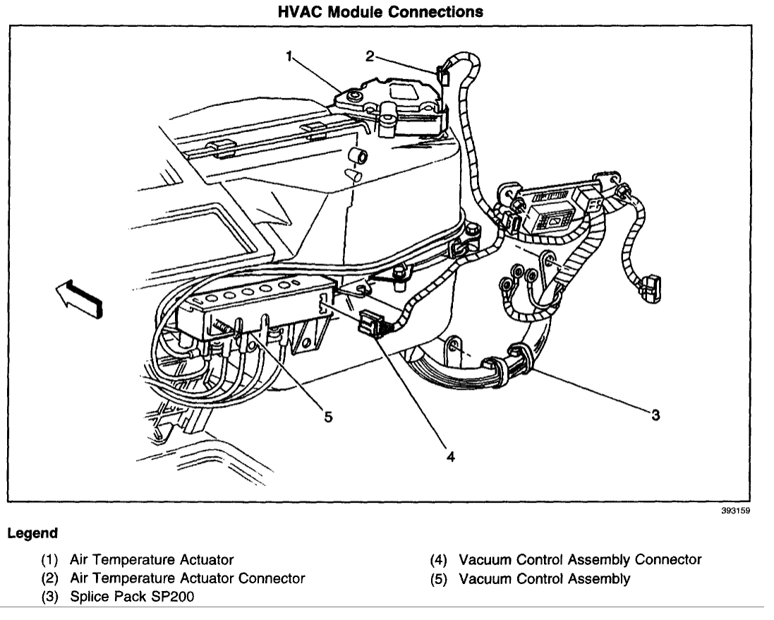

The master select switch is vaccum operated. So when not controled the blend doors go to default def/floor. Need to pull out master control see if vac. is present.Also see a vac. line coming from engine comp. close to evap box and through bulkhead. Is it pulling vac. If vac is good then replace selectswitch.

When I turn on the A/C the cold air comes out the defrost area and the floor but not the vents. Even without the A/C on I can't get air to flow out the vents. Is there a schematic that shows where the vacuum lines are? Or, is there a switch or something that I need to fix/replace?
Nov 26, 2020 at 12:02 AM (Merged)
MASTERTECHTIM
  • 4,750 POSTS
should be very easy. the vacuum line that goes into the cab is broken so you are in default mode. check the vacuum canister and trace the hose to engine then to the entrance to cab, it connects to a black plastic hose that comes out of a wiring harness at the firewall. be patient, you will find it.
