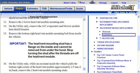

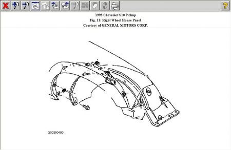

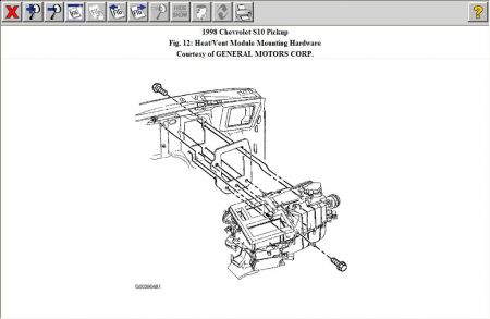

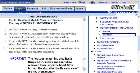

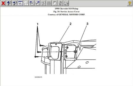

I am trying to remove my HVAC module to replace my heater core. I have already removed the dash and removed the bolt inside the blower motor resistor hole. Apparently there are 3 stud bolts running through firewall from engine side holding the HVAC module on. The top one at center of firewall is no problem. The two on bottom appear to be a nightmare to access. Not knowing anything about this, there appears to be 3 possibilities to access these 2 lower stud bolts: 1) remove black plastic shroud on engine side that holds blower; 2) pull front passenger tire and fender well; 3) drop exhaust from manifold and come up from bottom. Any suggestions on the best way to tackle this problem?

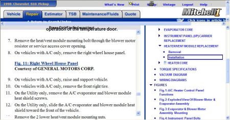

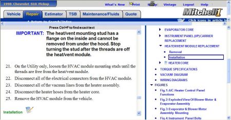

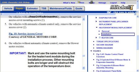

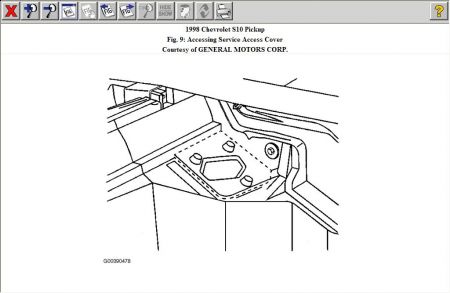

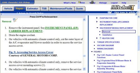

Hi Shadetree1337, Welcome to 2carpros and TY for the donation See below-sorry its too long but it'll do the job
https://images.2carpros.com/forum/automotive_pictures/12900_h1_12.jpg
https://images.2carpros.com/forum/automotive_pictures/12900_h2_11.jpg
https://images.2carpros.com/forum/automotive_pictures/12900_h3_4.jpg
https://images.2carpros.com/forum/automotive_pictures/12900_h4_4.jpg
